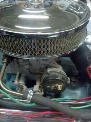

hi guys....great news. the 66 charger is ALIVEEEEEEEEEEEE...got it running today......anyhoo, theres an electric choke on the 383. looks to be a carter. theres 2 leads on the choke housing.....one dead center.....one off center. which one is the positive and which one is the negative ????? heres a pic............. 006.jpg
Doesn't matter. Hook the power up the the center and ground to the other one. Or not. Check for any markings on the housing near the terminals. They may be marked + and -
should be a slight width difference between the connectors so it should be obvious how they connect

theres no markings on it. i kinda figgered it didnt matter but i didnt want a fire. thanx guys!

wiring it in is not a problem since i totally rewired this car over the past 3 weeks. i just wasnt sure which was the pos(+) or if it even mattered. i can pull 12v off the run side of the ballast....or the pos(+) of the coil...it dont matter there. my only question was if anyone knew which was pos(+) and which was neg(-). thanx a million!
either way will work fine.i normally try to stay away from the ignition feed and pull my power from something else.i have heard of people having issues with even minor voltage drops in the ignition hot leads.(some on this site.)
Probably doesn't matter. On one of my cars with a Holley with this choke, I have the left grounded & the right wired into a "switched" circuit.
I've always taken the intial power off the ballast and have yet to experience any problems
