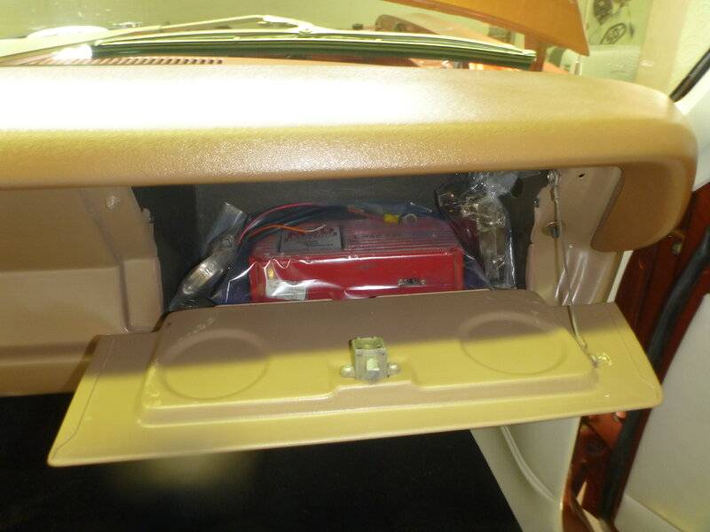

Get your pocket knife out, scrape'm, and drive home. As for 8000 miles, I still had the 1979 or older points in my Bee and was still driving it 30+ years later and close to 60, 000 miles. Never ONCE worried about getting home! Halifax Hops has good points from time to time, snag a few sets and carry them in the car. A lot easier to change than carrying around a spare MSD box !
