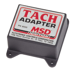

If your using a Mopar conversion kit you will be good to go. If you are going with an MSD I think you might have troubles with your factory tach. MSD makes a tach adapter if you go that route.
Yup....That's what I had to put in mine:
