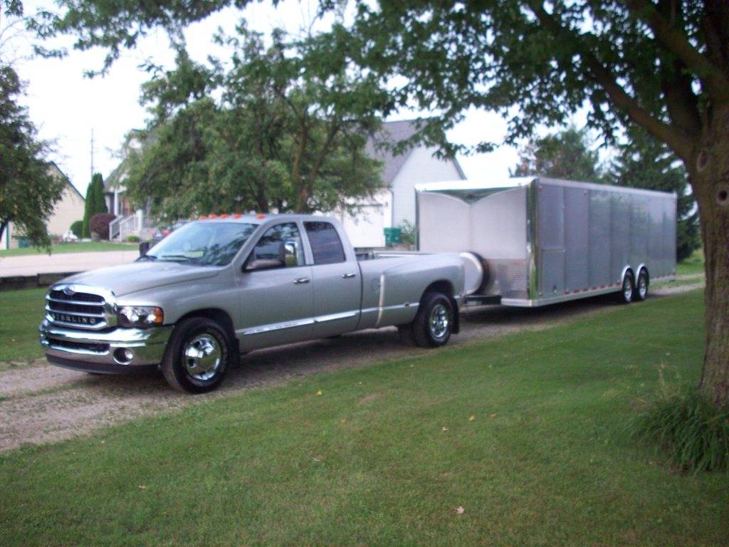

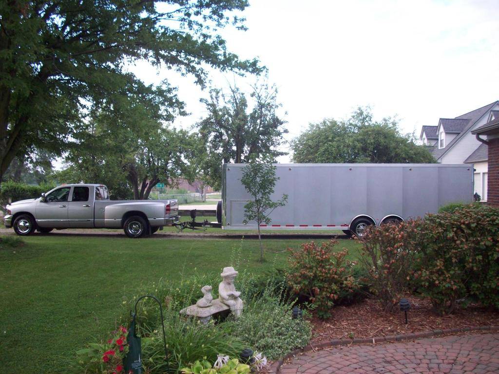

I really like my STORM "Cyclone". It's 28', and like closets, garages, and basements....if ya have a good pulling truck, ya won't mind having larger than you need. I should have gotten a 30' trailer.
Coyote duster, I tried to pm but got a message that your storage was full.
Should be good to go now ...
That's a quality trailer and a hell of a nice looking rig! :thumbsup:
Thanks. The trailer is very well made, but is a few lbs heavier than most. It's all tubing, without that "hat" and "Z" channel in the walls. I had it built to my specs[first trailer I ordered] and still would change a few small things.
