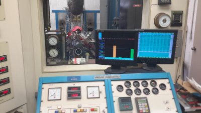

So now 10 weeks into it and looking for status update
“Your engine has most of the machining completed and will be going to final clean then to the assembly department”
So now I find out they are using my block and didn't use the core as they said they were on April 28th the core didn't get to them till around June 1st.
Whatit’s supposed to be done? More excuse’s
Onthe 16th week it On August 18[SUP]th[/SUP] it arrives. No pictures orpart numbers included in documentation so I ask about it,

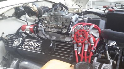

So install engine get everything ready to go, I prime oil pump fill antifreeze pressurize cooling system, oh damn water coming out of header. I have a different thread on that you can read here but they said I cracked the head.
http://www.forbbodiesonly.com/mopar...806-Cracked-cylinder-head-did-I-do-it-or-flaw
So on August 22[SUP]nd[/SUP] I start again with them on the cracked head. I also notice roller rockers which is on my final invoice are not in the engine, CME's response oops it didn’t make it onto build sheet. We will purchase and send to you. They certainly made it on the paid invoice.
Now I’m working on head issues and roller rockers with them.
It takes until first week of October to get the refurbished head from CME.

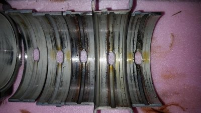

Put head on start engine breakin all good until I turn off change oil and go to restart, now engine is seized.
Get permission to start inspection from CME open valve covers no issues, oil pan no issues. Get more permission pop bearing cap. Oops bearings shot, after all bearings are checked on crank and rods there's not a good one. Have to then argue for another month with CME and they say in the
“boss says that you have some bad looking bearings and if that mess is ours, it is firsttime in 50,000 engines and 31 years 50000 plus engines no issue. send us crank bearings and oil."
P
Well guess there’s a first time. Finally after I have to ship crank and bearings to them they agree they screwed up. And they want me to ship them engine so they can rebuild. No way im not interested.
After much going back and forth they agree to pay for parts and we will part ways.
