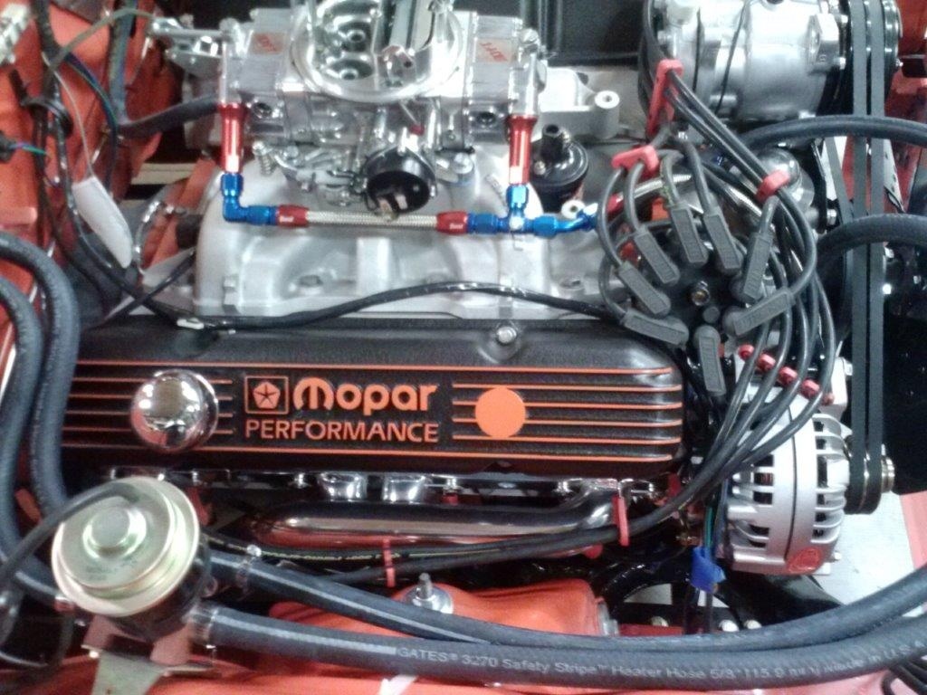

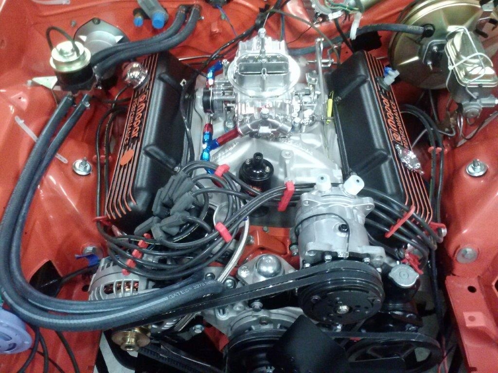

400 stroked to 470. Dyno'ed at 585 horses and 610 ft lbs of torque
That is a really sharp looking motor, if I may inquire, whats the specs of your engine.
Was going to send you a message about my motor but your inbox is full
Oops sorry im going clean it out.
Cool, cause out of respect to the OP, I don't want to fill his post up with my stuff but will share if needed to whom ever
