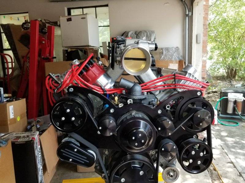

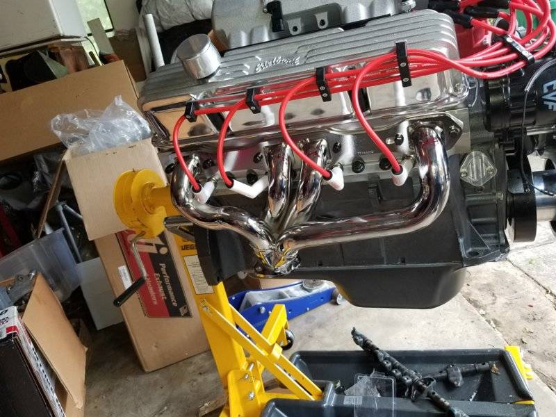

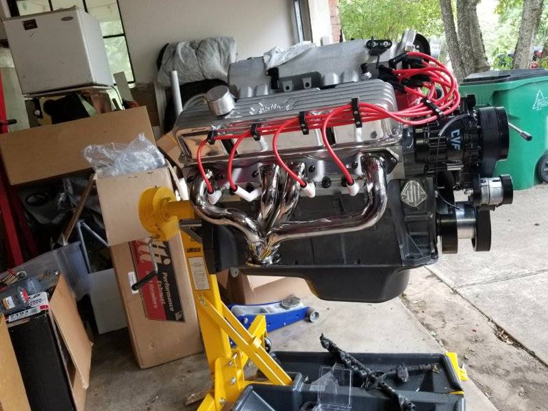

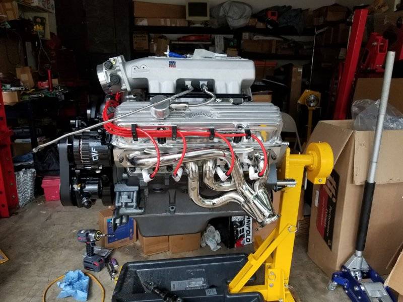

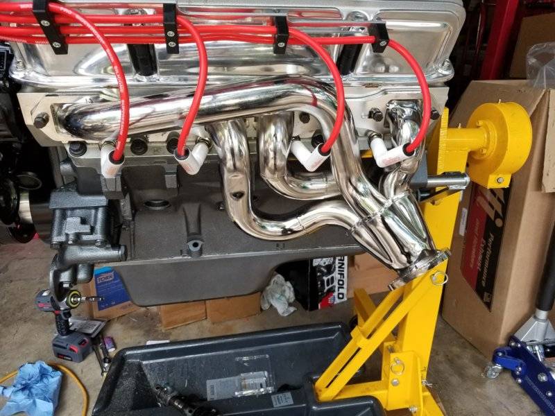

After 8 months, the motor is finally done. We got the plug wires dressed and some other things fixed. Hopefully we'll get it home in the car soon. Grill assembly is next.
Going to make some sweet music
Looks very nice... lotta attention to the details there! Are those shortys TTI??
Thanks for the comments. Basic specs:
73 440 .030 over, forged crank, 6 pack rods, Wiseco flaptops 10.5:1. Low tension ring pack.
Comp cams Nostalgia Plus cam, flat hydraulic lifters, PRW adj. Rockers on Marsh Sidewinder closed
chamber heads. CVF serpentine kit, 440 source sfi liquid balancer. Proflow 4 XT and yes, tti nickle plate shortys. I used Mallory spiral core wires with 135 deg ceramic boots. Looms are R&M
Target is 450-475 HP on 93 gas.
Tim
The plug wires look awesome. Good thing you won't need to adjust valves much. Very nice.
