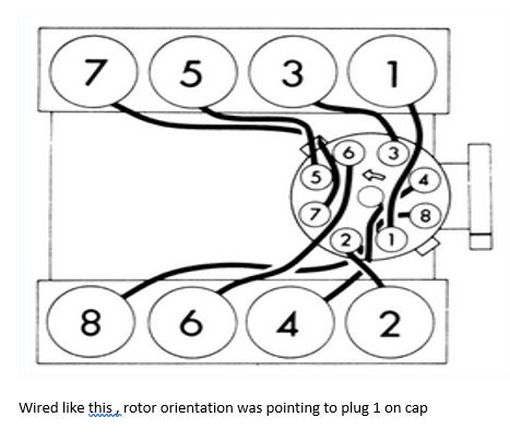

It ran before you changed the wires. Double/triple check the firing order. Counter clockwise on the dist order.
As long as the rotor is pointing to 1 plug wire on the cap and the firing order is correct and the correct order.here are the results of finding the compression stroke on #1 TDC

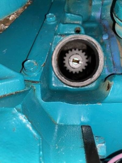

this is what shows once the tdc compression stroke stops
i have not moved the crank afterward
now im confused.
Should i put the timing mark on 0
then look at the rotor position?
again all i have done is get the compression stroke on #1 >
open the distributor cap to see the position between 5 and 6 >
then look where the timing mark is.
It looks like just the distributor... When I first looks I thought it was the gear.. And it could still be, pictures vs seeing it in person... When you pull the distributor look at the gear if the slot basically is aligned around 9-9:30 and 3-3:30 just rotate the distributor...thanks 1 wild rt,
so all i need to do is pull the distributor and spin the rotor to 1 right?
or do i need to mess with the gear too?

I can totally relate... Dad liked cars, had a few cool cars but he wasn't really a mechanic.. He'd get in there & fix stuff but he was better at construction than cars.... I on the other hand was doing mechanical stuff before I was a teen...You know 383 fireing order counter (clock wise) right ,just sayen. Were the old plugs black and sooty (fine black powder on plugs)if so its to rich, i had the choke closed to much cold start and blew the choke plate of the carb holly 4 bbl. Re adjusted float to proper level adjusted timing readjusted air fuel mix no more pop or fire.hope this helps.Car has been sitting a while due to having an intermittent start issue
i fixed that and one thing led to another cleaned up a few other things
lost order of plug wires
so i added new cap and rotor and wires
wired them up correctly according to some diagrams
now i get these pops and fires in the carburetor
