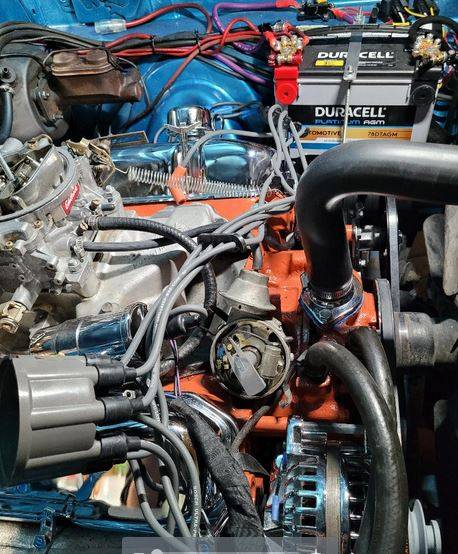

As long as the rotor is pointing to 1 plug wire on the cap and the firing order is correct and the correct order.here are the results of finding the compression stroke on #1 TDC

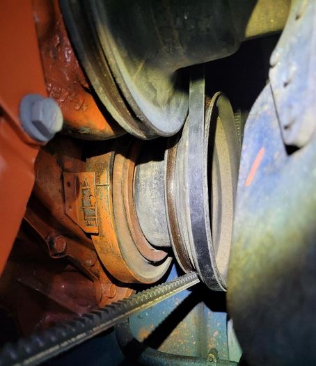

this is what shows once the tdc compression stroke stops
i have not moved the crank afterward
now im confused.
Should i put the timing mark on 0
then look at the rotor position?
again all i have done is get the compression stroke on #1 >
open the distributor cap to see the position between 5 and 6 >
then look where the timing mark is.

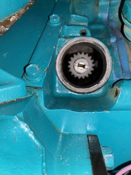

It looks like just the distributor... When I first looks I thought it was the gear.. And it could still be, pictures vs seeing it in person... When you pull the distributor look at the gear if the slot basically is aligned around 9-9:30 and 3-3:30 just rotate the distributor...thanks 1 wild rt,
so all i need to do is pull the distributor and spin the rotor to 1 right?
or do i need to mess with the gear too?
