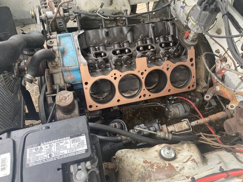

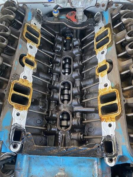

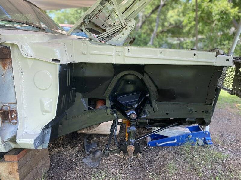

Thanks for all the reply's everyone, really appreciate it! My thought was to only take out the engine since the car is running good and i have already replaced all the transmission linkage. I also installed a new radiator with new transmission cooler lines. I did not mention that I previously removed the valve covers, heads and intake manifold to clean and replace all gaskets. A leaking plug on the head is what caused all this previous work. A new water and fuel pump have been installed with new gaskets as well. With the exception of the timing chain cover all gaskets are new.
As for the question of "how far you go", I purchased this car to build memories with my children and really want to have everything new by the time the first cruise is done. I really do not mind taking my time to do it correctly. Which is why I would like to leave the transmission removal for later, just to concentrate on that one piece.
The engine mounts are also new, i replaced them when i restored the k member and all steering and suspension components.

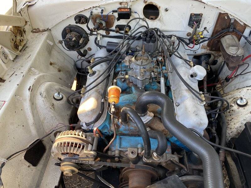

Are we sure that's the engine that came in the car when new?
I've owned two 67's and both were red.
Take sometime to clean connectors on bulkhead male and the female. The female ones are harder, there are sprays then dielectric grease to protect connections.
It's been a while since I've had a smallblock but it looks like the engine is from early - mid 70's.
I don't think it's original, for me it wouldn't be a huge deal anyway.
That color is small block mopar blue, not turqouise. At least that's what I think.
Looks like you are doing a real nice job on it!
If that's what it looked like when you removed the intake then that has been off in somewhat recent history.
...except a 67 318 would be 9.2:1 and a 70's engine would be 8:1 (if that).
