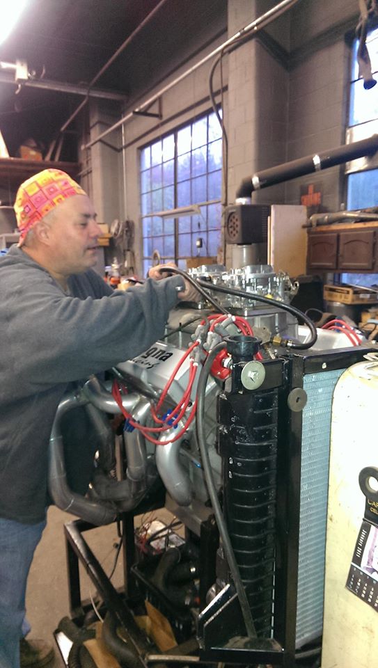

Why not do a modern max wedge. 572, good heads and a custom sheet metal crossram. I don't know, just thinking out loud.
Sort of with a indy crossram. BTW that's not me near my engine.lol
modern max wedge.

I dynoed my old motor with the stock cross ram and the Indy cross ram. 658hp vs 713hp. Back to back on the same day no other changes except jetting. From 4000 rpm up the Indy was better. It ran the 10 teens with the factory 1963 cross ram.
