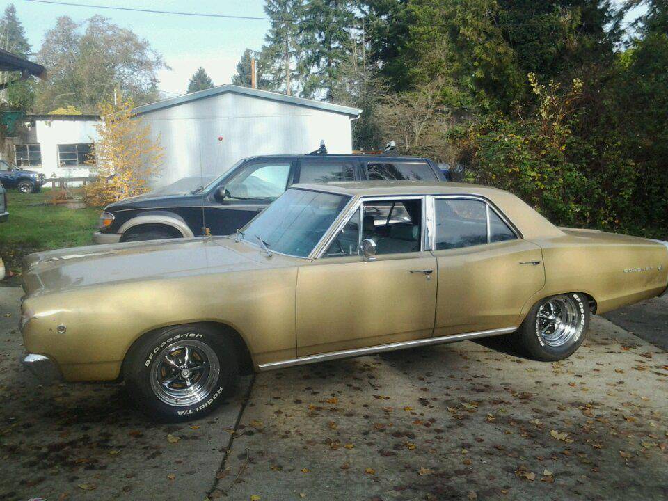

Hey that's a nice solid looking '68. I would drive the heck out of that as well!
Thanks, totally bone stock when i got it, still had the original rims and fitting tires on it. Radio delete base Coronet, only one code on the fender tag for the heater, someone put dual exhaust on it when they did the engine transplant though.
No rust, just a few dents.
