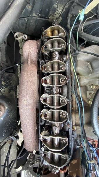

I have a 1970 383 4bbl in my 1969 Dodge Charger. I’ve been driving it a lot and it’s been running great all spring and summer. However, I start it up a few Sundays ago and it starts making a loud clicking noise form under the engine bay.
I shouldn’t have, but I drove it up the block and back. If the noise wasn’t there you wouldn’t notice anything different in how it ran and would think all is well.
Today, my cousin Josh and our friend Kenny came over to help diagnose it.
We took the valve cover off and nothing is loose or missing. We even turned the crank and checked all of the rocker arms, etc. with and without load. We then left the valve cover off and put cardboard between the cylinder head and the exhaust manifolds and started it. When we did that there wasn’t any noise at all! It went away completely!
We reinstalled the valve cover and the noise is back. It’s never done that before. We even used a stethoscope type tool to listen to the engine with the valve cover one and it sounded the same everywhere. It was much louder when placing it in the exhaust manifold (factory exhaust manifolds, no headers), but it was consistently the same type and rhythm of noise no matter where you placed the stethoscope.
Baffled as to why when the valve cover is on, it clicks. When the valve cover is off it doesn’t ‍
