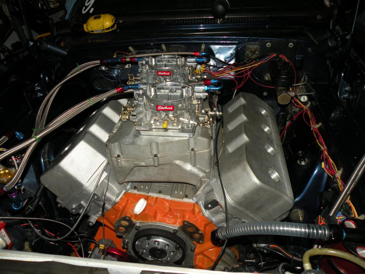

Erratic Idle; OF COARSE!!!!!!
wedge5
2:35 AM
Jul 31, 2009
902
69
Central IL
I got my crossram running tonight but can not for the life of me get the idle set. I checked for vacuum leaks with carb cleaner but nothing. The car starts and the idle is hi(1800-2000) if I turn it down just alittle it almost dies(500 or less). if I turn it alittle when it is low it sky rockets, 1800-2000. I guess I need to check the DVD that they sent with the carbs to see if there is something that I am missing?
ANY IDEAS???????

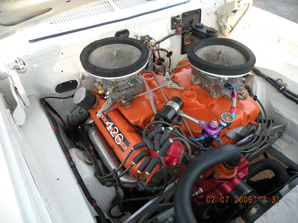

Thanks for your time Fugly. I know you are busy.
Mixture screws out 2 turns,idle screw in 1 1/2 +1/8 turns,tried 1 1/2 turns but it won't start/run,car starts and runs around 1800(vacuum reads 9 on both carbs). Car warmed up, linkage disconnected.
I checked the metering rod springs. When the idle was down to 1000(car barely running) they were popping up but when I get it the car to 1500 they are down. I hit the gas and they pop up.
Now on to the idle. It will hold on 1600/1500rpm so I turn the idle screw 1/8 or less it lowers it some but not much, maybe to 1500. I think that I am getting somewhere so I turn it a little more maybe 1500/1400 so just a little turn on both(vacuum now reads an unsteady 5) the motor will flutter and then die. I did get a look at the tach while it was fluttering before it died (1000/800). I have tried many,many times to get the idle to 1200/1100 to no avail.
I haven't adjusted the mixture screws from the 2 turns out since I can't get the idle to 1200rpm. I have checked a few times for vacuum leaks but haven't found any. The idle will hold steady at 1500 but when I put it in gear it drops below 1000 and will not stay running without help. It could be the convertor but the only thing changed on the motor is the intake and it ran perfect before the swap so I don't think it is that. It is very responsive when the pedal is hit, real crisp with no bogs(in park anyway). Why do all the Mopar guys live so far away!!!!! I am going to try again on Tuesday afternoon because I messed with it for about 4 hours on Friday and just had enough.
