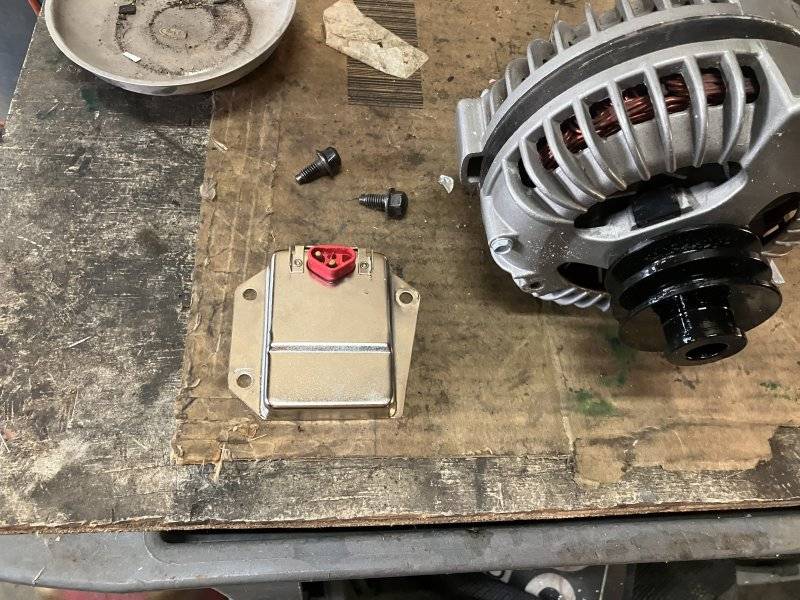

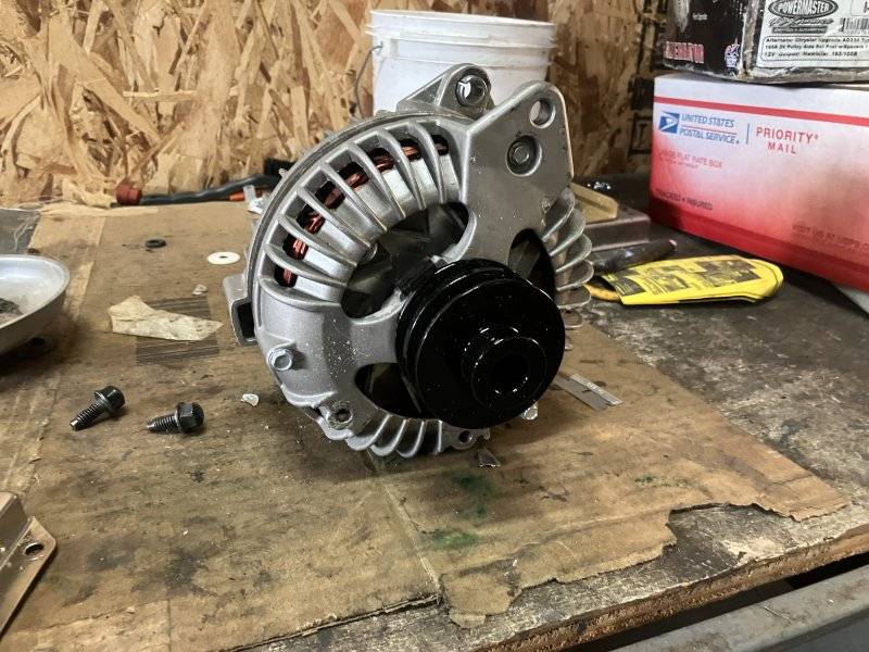

I bought an alternator from this guy....

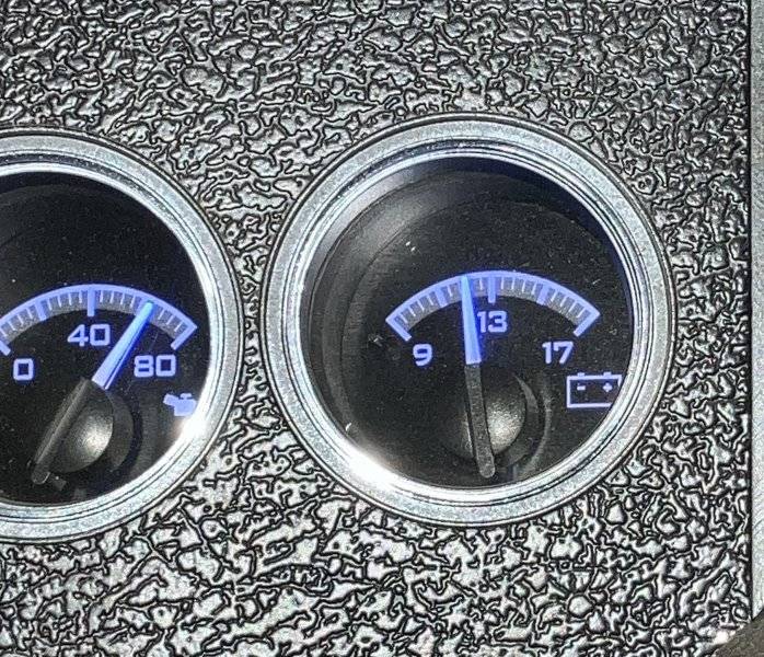

I repainted the pulley black. Otherwise, it is just as I received it. Tonight's reading with the existing parts store alternator:

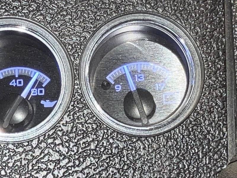

Idling in neutral at 1000 rpms. Low beams on.

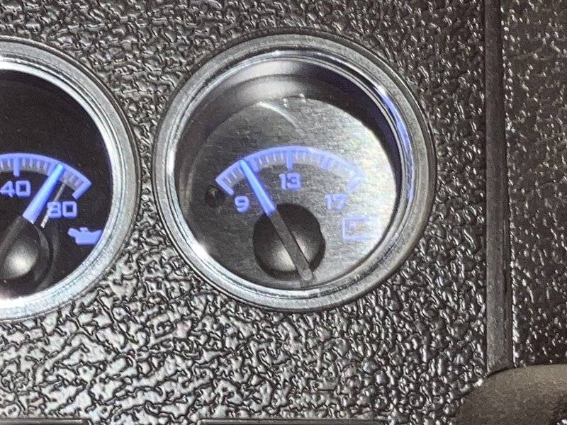

High beams and A/C fan blowing.
Headlights off, fan still on.
With no headlights or fan going, it usually runs over 13 at idle. Revving it up to 2000 rpms pushes it over 13. With the high beams on and fan going, it rarely gets near 13 amps even at 2000 rpms and above. This alternator is fine for daytime use though.

I don’t know if the black pulley is factory correct. I just like how it looks.

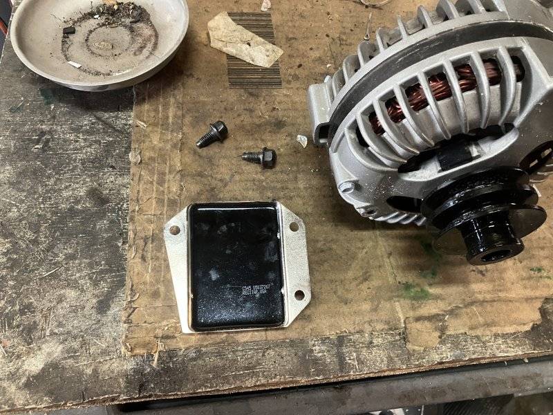

This looks like a generic VR but the seller said it was what was recommended.
