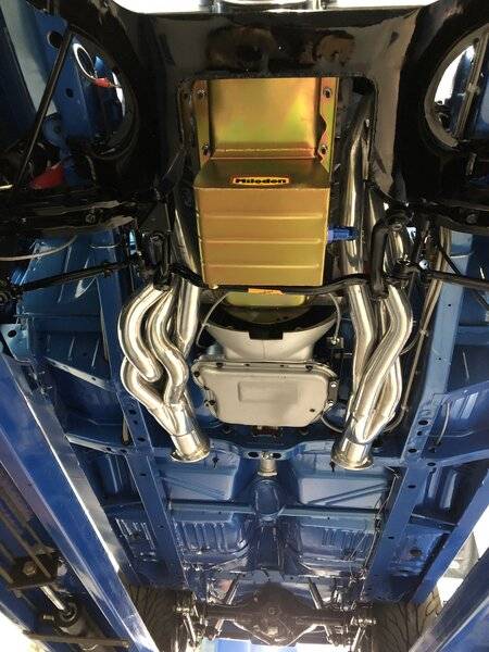

I do have headers . 2 1/2 mandrel bent with X pipe. Dyno max Ultra flow.
In my opinion a decent flowing exhaust.

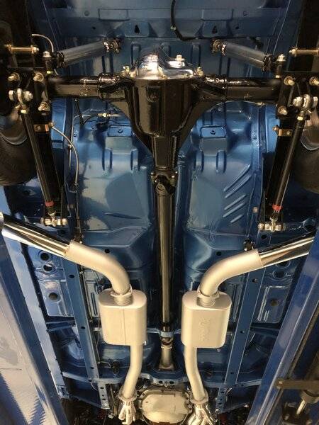

I thought about cut outs on my Dart exhaust but decided against them. Behind the 2.125 X 3.5” TTI’s I chose to go with 3” into 3” Dynomax Ultraflow mufflers and 3.5 after.

I chose to drop the pipe size to 3” to quieten it down, the stepped up tail pipes won’t hurt it. I’m hoping to get thumbs ups rather than a noise citation.

My street car has 3” Ultraflows with turn downs.11.01 thru the exhaust. Earlier in its life with 3” Flowmasters. 11.66. Removed the exhaust system (76#). Same day 11.61. Good system looses next to nothing except added weight. My wife’s 9-1 comp factory head 360 Challenger has never run w/o full 2 1/2” exhaust and air filter 12.52@110. Same with my sons 360 turbo 62 Savoy. Full exhaust 9.55@142.
