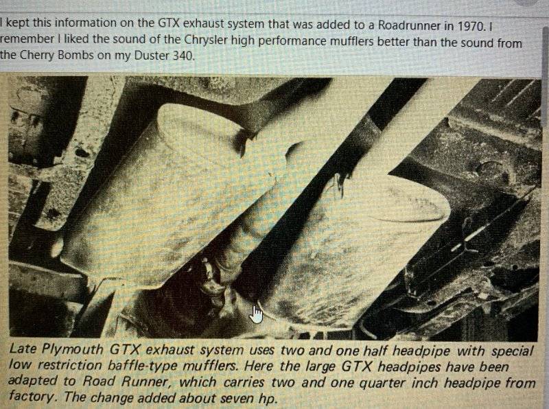

How does going to a smaller exhaust produce more hp? To my thinking larger exhaust would allow more airflow through the engine and therefore you could supply more fuel.
I think you’re misunderstanding the text. It’s saying that there was a 7 horsepower gain by switching from 2.25” to 2.5” headpipes…
Additionally, the further downstream in the exhaust system you neck the pipes down in diameter, the less impact it will have on performance due to exhaust gases cooling and pressure correspondingly dropping.
I had to read it a couple more times but ya, your right. My oops.
