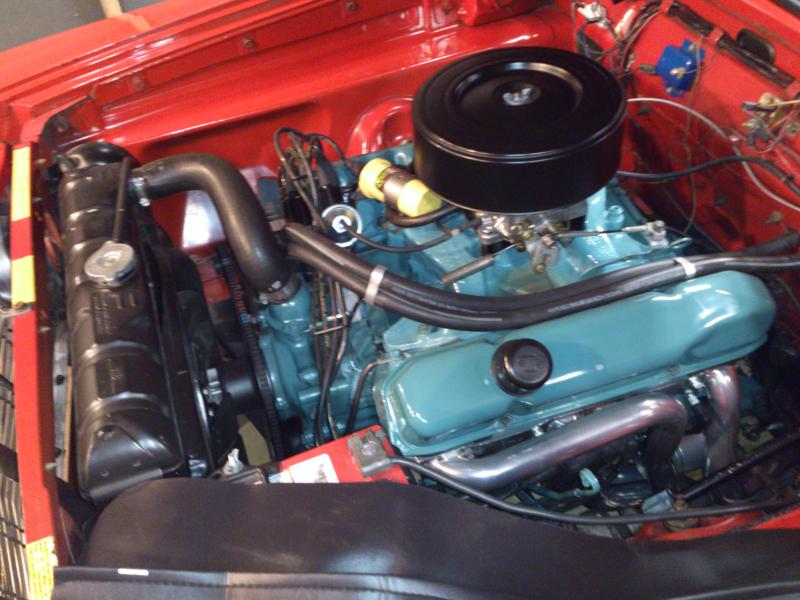

you could use the studs..like this..works great!
mopar bill has the right idea,,2 nuts....''':eusa_think:

thanks for every ones help but all a little late i got them all out but 1 1 of them broke off i even busted a easy out had to drill it out and then use another easy out but dam i got it finaly after a little cussing though lol i just heated them up a little and came right out but sonny i cant see what ur refering too?? or i cant see in the pic but if u put headers on y would u use old studds n y would they leak if there tight? i have header on one of my other cars n they dont leak any anifreeze?? let me know guys thanks again every one now i need to pull engine out of the car and put refurbished k frame and put engine n tranny in oh ya no time latley with is being harvest time here in the big state of nothdakota lol
He used the old studs because the holes go into the water jackets. Be sure to use thread sealer on the header bolts.
Yea they are right, headers can be a major headache. Seems to me only the front and rear bolts go into the water jacket? keep an eye on it. If it ever looks like a head gasket leak, check header bolts first. And they need to be re tightened regularly. I'm using stock H P ex manifolds on my 451, and it runs great! But headers would help power output I'm sure. N D is a great state! I been workin in Williston, just left today! Back to Colorado now. Good Luck!
I use studs on all except the rear #1 hole, I use a bolt due to clearance..it's also in a water jacket. It depends on your header pipe configuration.
