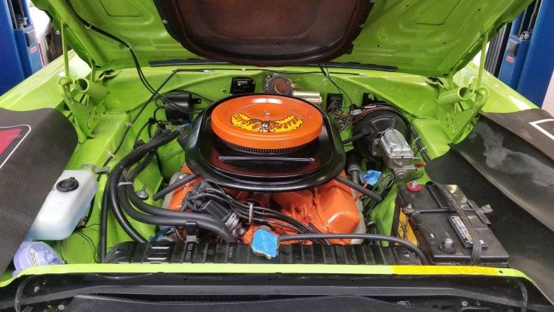

My 500 stroker in my Road Runner makes 675 lb/ft of torque. I also drove it on the Power Tour and it got 16.9 MPG on the highway. It has aluminum heads that I painted to make the car look more factory (it also has other hidden mods like A/C, fuel injection, etc.). Here is a picture of the engine compartment:
So my suggestion is to stroke the original 383. Put a good roller cam and free flowing heads on it. You can still tell people it has the original engine and transmission in it, which is true! Make it look as original as possible and then drive it and enjoy it. Any unused original parts (like the original heads) can be stored pretty easily and don't take up too much room.
