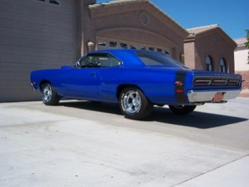

call Gary at classic air, I put a/c in my non a/c 69 coronet and the system works great, the instructions suck but a few phone calls to Gary made it almost painless. all in all, it was the best money I spent on the car as i live in Lake Havasu, Az. 130* in the shade
