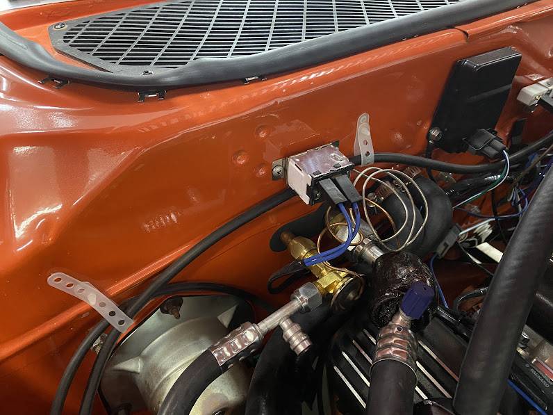

I am no AC expert by any means but it sounds like it froze up. How do you have the temp cutout switch sensor connected? It needs to be insulated real well so engine heat does not affect it. I found the insulation supplied by classic sucked so I bought a roll of good stuff and insulated it properly. I also used a hose clamp to secure it to the line instead of the crappy clamp they provide. If your going to Carlisle I can bring some of the insulation for you. I have 25' and only needed 1 or so.
I glad you posted this picture of your lines and firewall. I will say the switch they provided is similar to yours but not the same exact (probably just a different vendor) I have my switch secured off on of the fan motor studs hoping to hide it a bit and yes then you to that tube along with the capillary from the expansion valve. I know I used a worm clamp instead of their provided piece. I can't swear though if the one from the switch is also clamped to the tube or just held in there by the black tape stuff.
