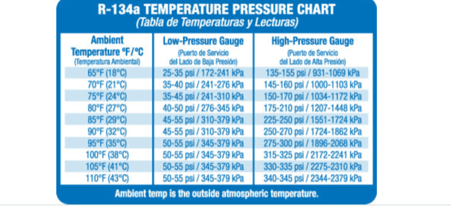

In the original post RJS posted
"So today it's 82 degrees with like 70% humidity and I have (3) 12oz. cans into the system (36oz. total) with these #'s 15 low side and 165 high side"

Per the industry standard R134 Pressure/Temperature Chart which is posted in my above post with an ambient temp of 82 degrees the high side should be reading around 200-240ish... It's 165.... I stand by the suggestion the system is a little low... Popping in and throwing a red X aught to be followed by an explanation to support you opinion... Otherwise your just an asshole...

Here is the chart you need not that stupid one with the pressures to blow up your system.
Quick math for high side is 2 to 2.2 times Ambien temp, high humidity is 2.2.

Thanks for getting back to this.... Interesting that the numbers on your chart are lower than the chart I've been using for years.. When I was certified for R12 & R134 there were standard charts, the numbers on the chart I posted match up with my old literature so I plan to continue using the numbers I've been using.... Haven't blown up an A/C system in the last thirty years.... Pretty sore I won't this week either...

I concur....your chart illustrates the relationship between TEMPERATURE (condenser air inlet temp) and PRESSURE (condenser refrigerant inlet pressure) ....or Boyles Law. The other factor I consider is the EVAPORATOR air outlet temperature and the velocity of the circulated AIR..or air temp at the dash vents and the average RPM (engine speed) the compressor is turning. Higher RPM's equates to higher pumped volume of refrigerant and the heat exchange ratios for a given refrigerant type (specific heat characteristics or condensing and
evaporating rates) ..more refrigerant equals greater heat exchange limited by the surface area of the respective heat exchangers. REMEMBER...you are not making cold, but removing heat....
he FSM's are fairly explicit as to charging conditions and rrecomdations but prior experiences and results are very important considerations.......just my opinions and thoughts.....
