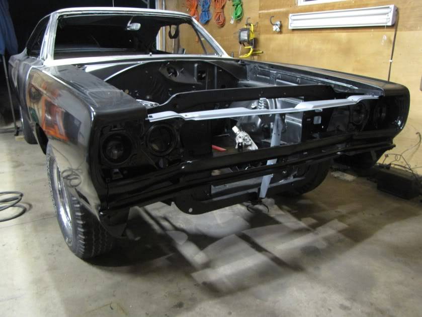

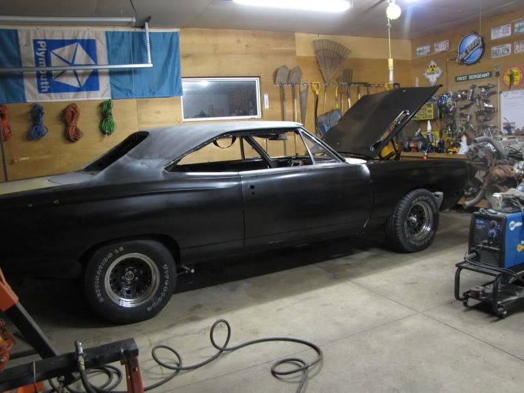

Kind of a crappy night on the bird tonight. Had a buddy help me toss the hood on. In the process I had one of the upper/rear hinge bolt snap off inside the welded on square nut on the inner fender..Sucks...Wasn't even wrenching on it that hard at all. Time for the easy out or drill out.
I also noticed that the drivers side hinge is junk. The arm that extends out under the spring has a loose joint and is pulled in towards the engine bay when the hood is up. Impossible to tell when I was cleaning them all up. Ahh well, life goes on...
A pic with the hood on......

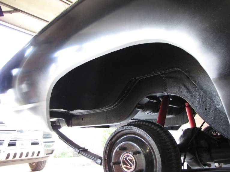

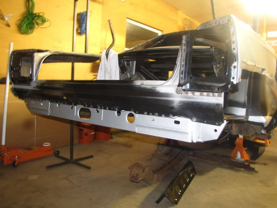

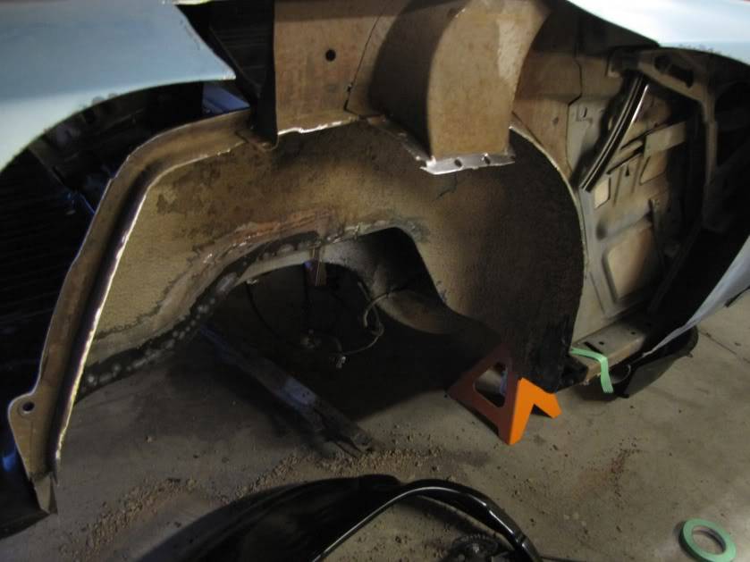

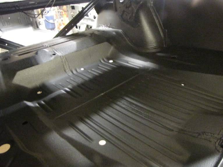

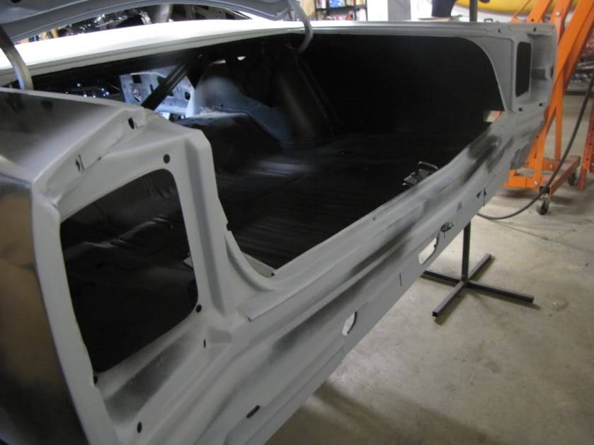

Kinda boring stuff going on right now...Getting her prepped so I can march forward with the body work once I get her trailered to the body shop.
Ground flush the last remaining spot welds in the rear wheel house lips, botton of the rockers and quarter to extension lips. Skimmed over with some Rage, brought back down with some 100G then 220G and primed.

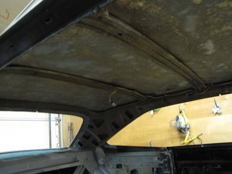

Also got the old headliner out. Not too bad underneath suprisingly. Pretty clean yet. Only the front section had the remainders of a mouse house in it. Tomorrow i'll be wire wheeling to shiny metal and coating with some rust Bullet.

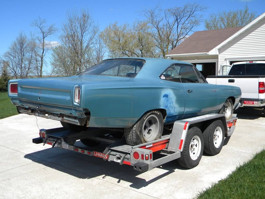

Well........Bit of an update fella's............
Yup!!!!! Roadrunner made its way to the body shop today. Quite a feeling pushing her in that trailer and walking back to an empty garage, especially since I spent soooooooooo many late nights and long days in the garage bringing her back from the dead.. Almost felt like I was loosing a pal.
Biggest problem is.......I don't know what the hell to do with myself!!! They'll be starting to work on the car next week with the transitions and skim coat. I'll be joining in the festivities when my work schedule allows. Crappy part is they're not open on the weekends. I guess the Coronet will be getting some needed attention here in the next several weeks.

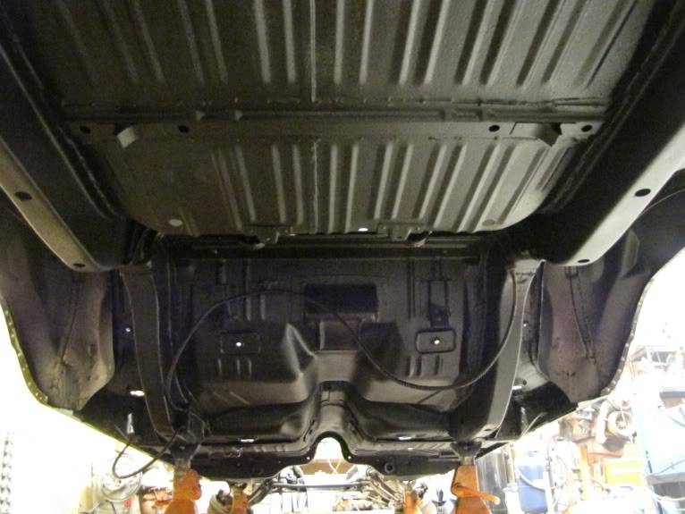

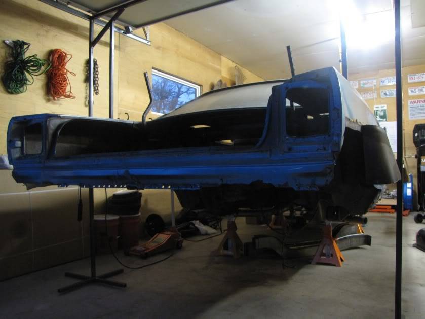

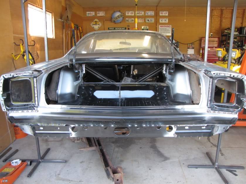

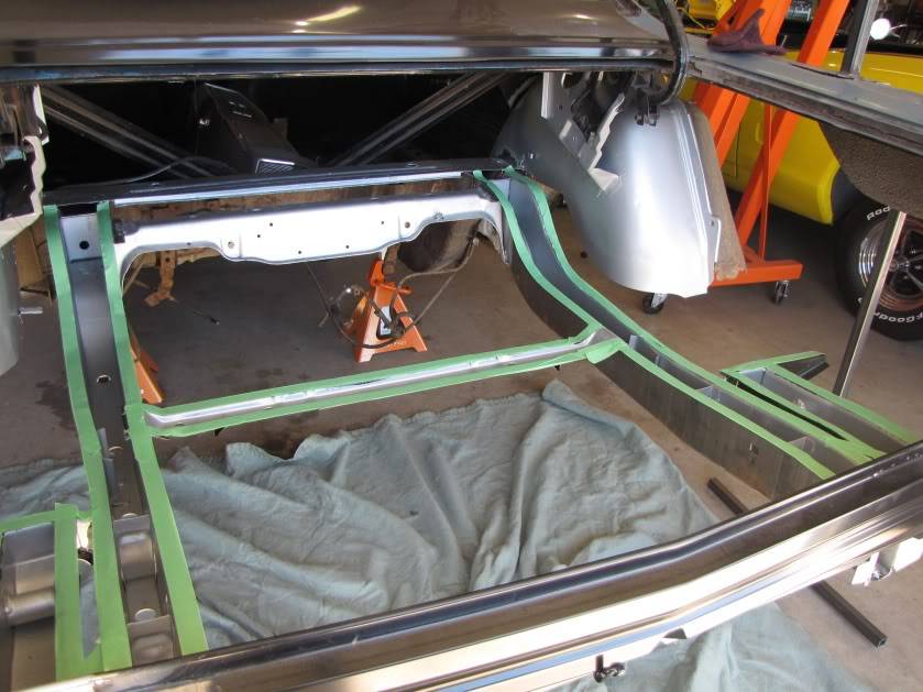

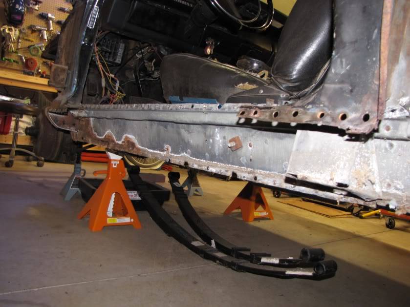

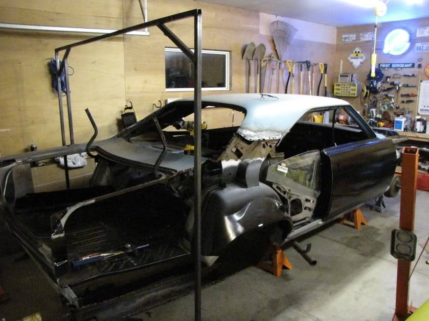

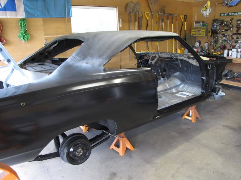

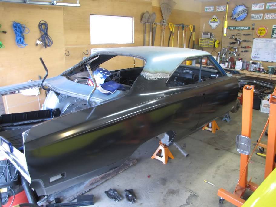

I went through all 400 pictures of the work done so far and am wondering; (A) I must be a glutten for punishment. (B) I must be half Crazy. (C) When is the next time i'll be able to tear into some rotton metal....LOL. Thought I'd toss up some pic's of the road traveled thus far on ol' Skeletor..
Happy days boys...happy days
Obviously just a taste of whats been done over the past year....It's pretty neat to look back once in a while and see what you have done. Goes to show, a man puts his mind to something, he can accomplish anything. Also that hard work, does pay off!
