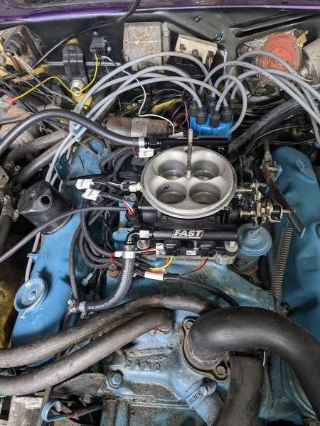

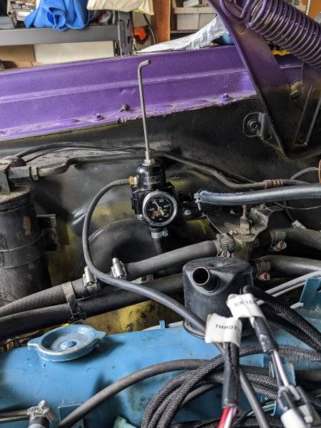

Hello guys and gals, I've finished the install on my project. I've done everything from start to finish. I installed the EFI master kit to my 72 Satellite with a 360. My worry was the fuel system. After hooking up everything and checking it like 10 times. I turned ignition on and fuel pump fired up and pressure went to the moon. Pegged. Also handheld didn't turn on. Good thing about it is it doesn't leak fuel. I'm beat up, cut up and pissed. If anyone has a suggestion I'm all ears. Thank you
Well after checking everything 10 times did you call the company? Sounds like multiple problems. Not powering up for sure is either a component failure or mis-wired. The high fuel pressure not knowing what you have could be a bad regulator. Is there a return? If so is it clear and free flowing?

I would want it powered up first. How is the fuel supply set up? From what I remember the pump fuels direct to the Throttle body and there is a regulator on the output side of the throttle body going back to the tank. This has to be free flowing and not dead headed. If by some chance its plumbed wrong or restricted on the return it will cause very high pressures. I believe desired pressure is in the mid 40's.

You had another post on return lines. Did you run a larger 3/8 or bigger back to the tank from the regulator?
When the pump is running be sure fuel is going back to the tank. You could take the line off at the tank and run it into a can. If still high, mark and back the regulator down.
Had to add fuel nipple to tank for return. Regulator now is at 42/43. Works great no leaks. Can't get a tune. Handheld just blinks. Can't seem to rebut. Bypassed long cord and still doesn't boot up. All hooked up and can't get a tune.

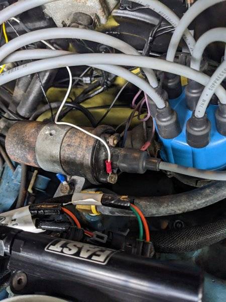

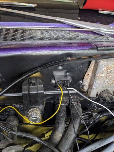

Entered questions and tried to start when prompted. Not firing, no spark. It's a 1972 satellite looks very stock as ignition goes and had great spark before swap. Didn't mess with any of that. Only wire hooked up different is RPM module to coil. Where's my spark?
Looks like a disaster to me. I dont know where to start.

Remove the tach signal wire you attached to the coil and then see if you have spark.
It needs a signal and that white wire comes from the RPM Module. With this type of ignition it calls for it.
