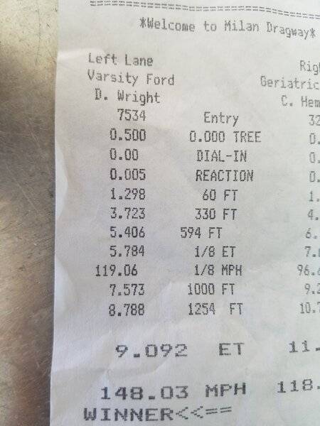

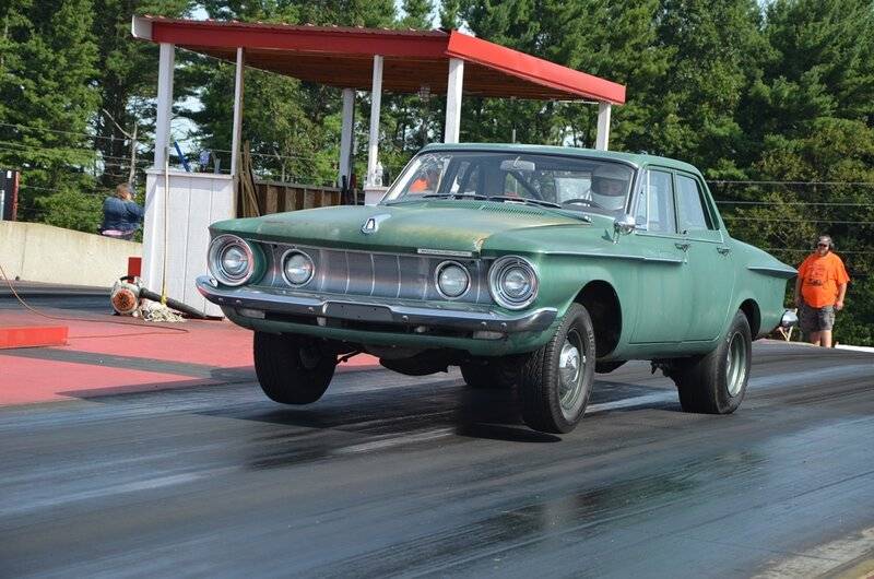

We don't think so. But you ought to see the looks when we show up with this 62 running mid 9's. Nobody knows what it is. I'll through in a time slip from my 64. Don't see any disadvantage.

That 1962 Plymouth is running stunning times indeed and I was thinking about a 413 max-wedge myself.

ps why does the timing ticket say ''FORD''...:poke:
Thought Milan was in Italy, I smell something fishy!:luvplace:

Milan is in south eastern Michigan. Varsity Ford is a track sponsor. And you would be surprised how light a steel B body can be and look stock. Full race weight with driver and fuel is just under 3300lbs. Many A body small blocks that are heavier. The 62 has no lightening. It is 3775lbs race ready.

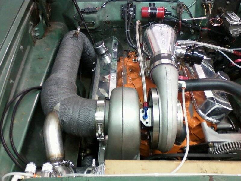

Doug isn't your sons car a 360 ? Is it twin turbo's he built himself ? Thanks , Ron
It's a single turbo blow thru carb without an intercooler. Yes he built it.
Doug
Nice, is that W/M or Nitrous I see?
And what alternator is that?
Thank you
It has no water/meth, E85. That's the boost reference line. 76 mm turbo, 360. Filled stock block. Stock cast crank, Eddy heads, truck manifolds, .550 hyd roller, 750 blow thru Holley, 3.54 Dana, Trans brake push button 727. Best ET 9.55@142. There more power in it for sure. But we might have to sweep up the crank. Been together for years.

It just shows how much power you can make on a boosted eng. His is not a big eng and not even using headers and a cast crank. Its amazing it has stayed together so well. You gotta figure thats a 12 second car without the boost I would think at best. It makes me want to hurray up and get my sons car done this year as its a 451 thats getting supercharged. And it has good bottom end parts in it. Ron
So let me get this straight!
The 62 car is running a cast crank 360 with a 76mm turbo through cast truck manifolds at 9.55...:asskiss:
OMG, that is darn good!
