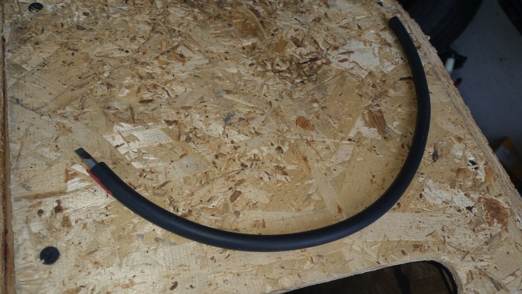

Here is "special outboard carb idle screw adjuster 606127a" (lol) aka vacuum tubing for Mopar distributor vacuum can with a mini flat blade bit inserted. The red tape was to help visually see the amount of turns, but the flat parts of the bit is a better incremental guide. I also used a flashlight and a little 90° hook pick tool to guide it into place.

What prompted this round of carbs tweaking was the new FBO ignition system and I knew my idle was too rich...made my eyes water there were so many gas fumes. The center carb idle mixture screws all the way closed making the rpms increase and the motor smooth out pointed to an obvious problem that the outboard carbs needed to be leaned out. Big improvements so far, probably going to "dick around" (lol) with them a bit more, but I am really close IMO to 6 bbl idle nirvana. I will install the jetable aftermarket metering plates in the outboard carbs next.
