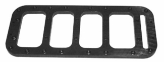

block needs a block girdle at a minimum....

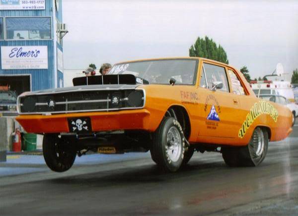

I have a 528 ci Indy Hemi crate motor in the shop right now that we are rebuilding. It needed a massive rebuild at 500 miles. The list of corrections is extensive.
Not a 440 based 500 engine,but a 400 based 493 ci. engine.
Muscle Motors short block.
Scat rods.
Ross pistons.
Mopar 4.15 crank.
3/4 block fill.
Flat tappet cam.
Indy Sr heads.
Before the cam change to a solid roller the car went 9.50's.
According to the Moroso slide ruler.
3000 lb car 9.5 et=650 hp to the rear wheels.
250 pass's on block.
No girdle.
Replaced 1 sleeve.
I should put a girdle on the engine.
The car runs off a trans brake.
As far as the 440 Source rockers,mine are very noisy on my 512.
I have only missed 1 round of racing because of engine failure in the 250 pass's.
Engine was freshen'd up around 150 pass's.
Just trying to show with the right parts you should get reliability.

I did a all gear dyno run and got 683 rear wheel hp number in 3rd gear.
Forgot about doing that.
Haven't had the engine on a engine dyno.
Did the all gear dyno pulls to find out where my shift points should be for each gear as the peak tq numbers move with the different gear ratio's between gears.
It's also very hard on the car.
