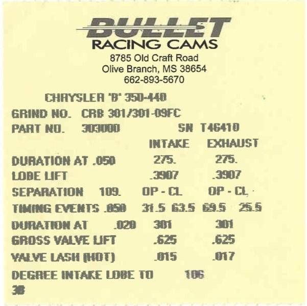

Here’s the cam card to the Comp Hyd. roller.
