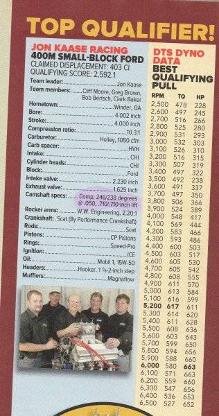

Jon Kaase won the EMC with a cam ground on 98 LSA, 92 ICL. It made 663 hp & dropped a mere 9 hp past peak hp.

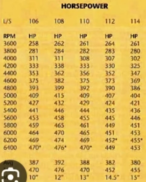

Below is comparison on a sbc of LSA's on a dyno. I don't recall where it came from, and was hesitant to post because the cam/engine specs needed to be mentioned and it is not a 440... but the affect on vacuum is also interesting. We run more compression with wider LSA's, and that is another subject. They did not do a 104 in this test. But it was not getting better.
