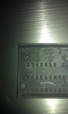

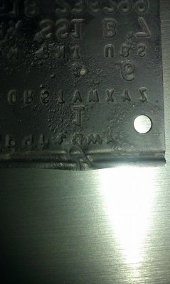

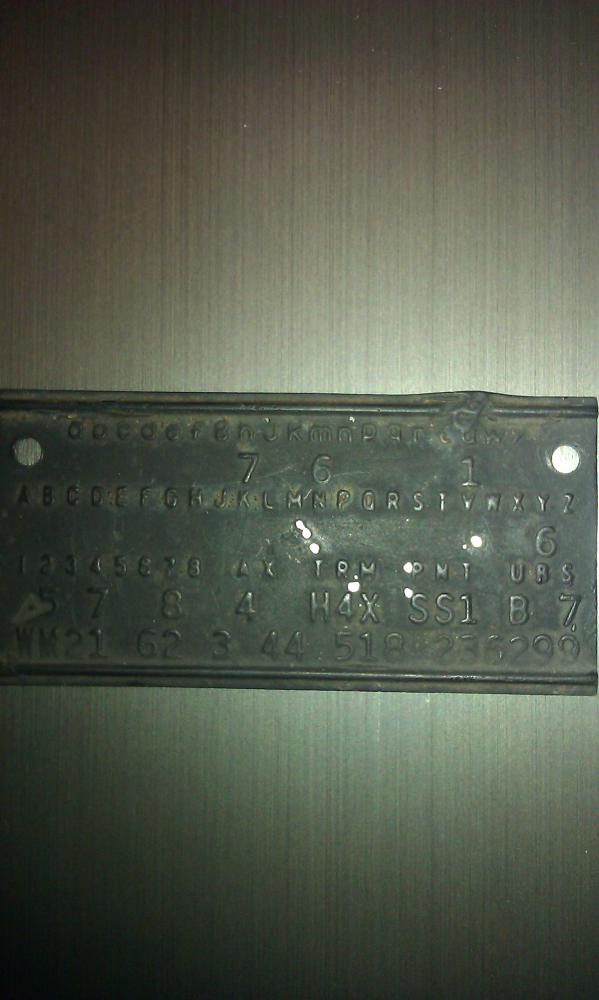

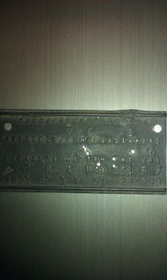

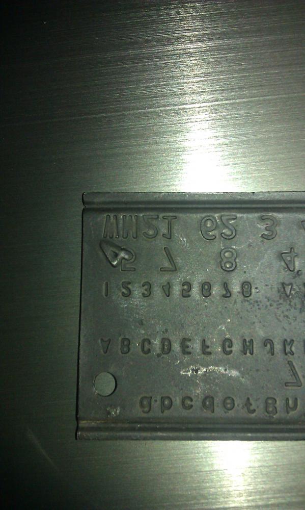

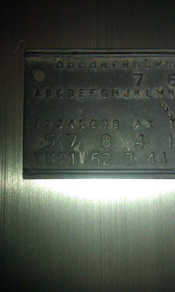

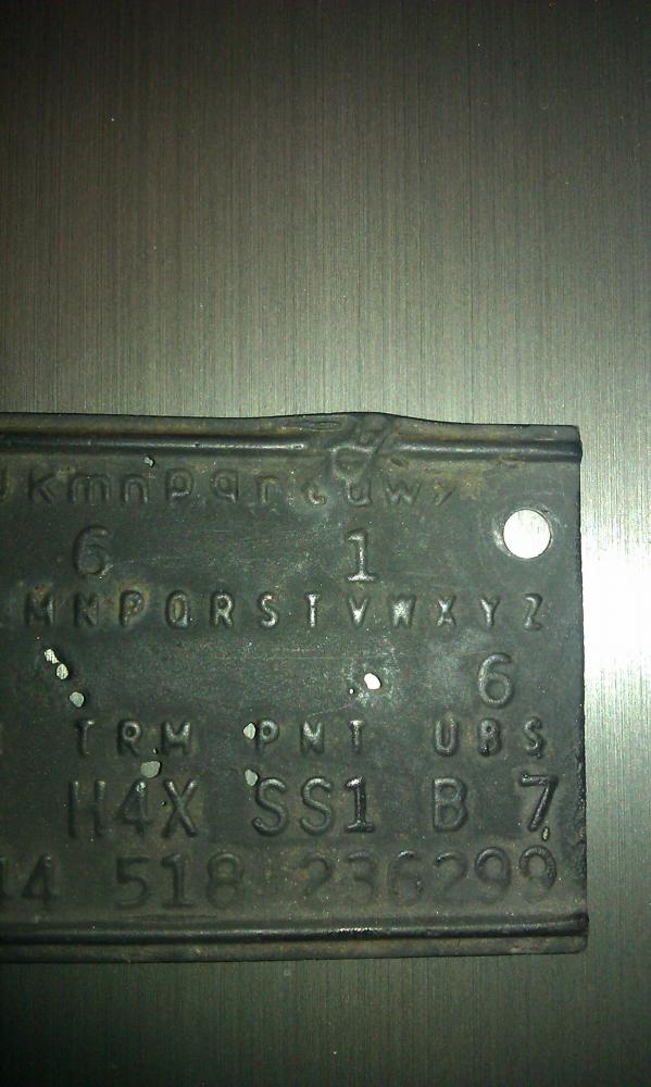

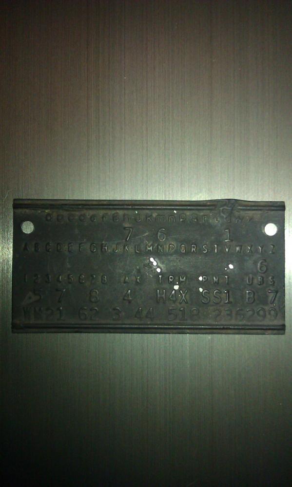

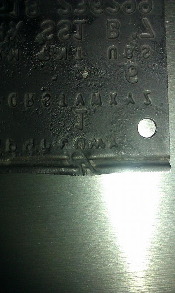

I have the tag of my 68 Super Bee. I am going to register the car at the super bee registry and there are 2 out of place stampings. I don't know if they belong somewhere on my tag, or my tag fell on another one being stamped or what. Threw a full shot of it for all those that like to decode these things.

Love the '68s and this one would be no exception.
Post coupe, 383/335, 4 spd, black bench, red lines, pale yellow, black vinyl, white but stripe, fender turn signals, LH remote mirror, 3.23 axle, drip rail, B-pillar and wheel lip moldings. Built on May 18 '68 and the u1 would be a sold car/expedite.
If you are referring to the stamped characters from the back they are inspection marks and quite common.
If you are referring to the stamped characters from the back they are inspection marks and quite common....
...from cars built at the Lynch Road assembly plant. Typical stamps. Nothing unusual or confusing about them.
