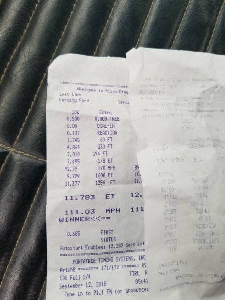

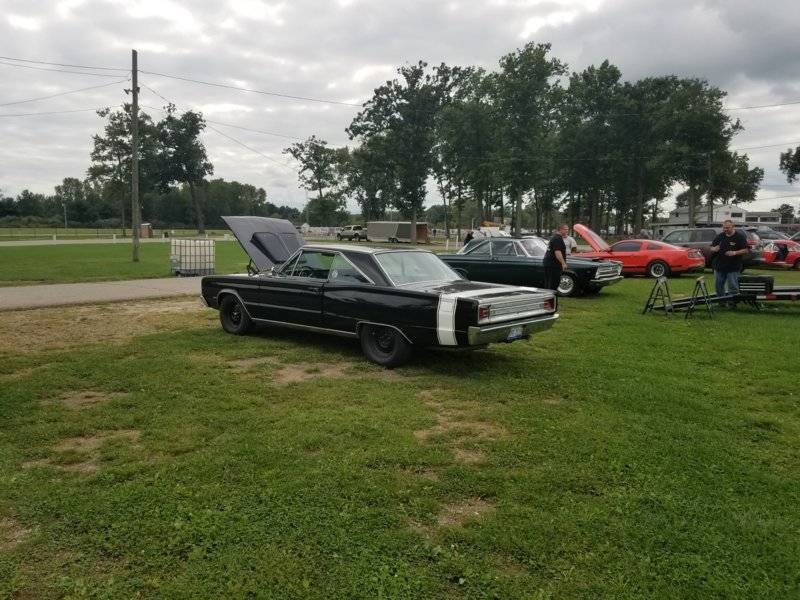

440 +55 over 499 cubic inch Indy 440-1 heads. Comp cam Diamond pistons. 727 built by DVW. Best Machine did the motor. 4.10 gear p255 60r 15 Mickey. Trying slicks next

Certainly a better tire would help some, but the 111 mph (I.e. horsepower) seems like it might be a bit off. Have you talked with Chuck or Pete about your numbers?
No. This was my first time ever going to the track in any car was letting off the gas to early. Motor made 615hp and 624tq. Hopefully the taller tire will drop my rpms
Rough numbers, you should have a 1/8 mile speed of 100 mph, and trap speed of 123 mph to go with that horsepower. You may have lifted early, but you're 1/8 mile mph suggests a trap of 115/116 mph.
Keep plugging away at it. It'll take some track tuning to dial it in if this is your first time.

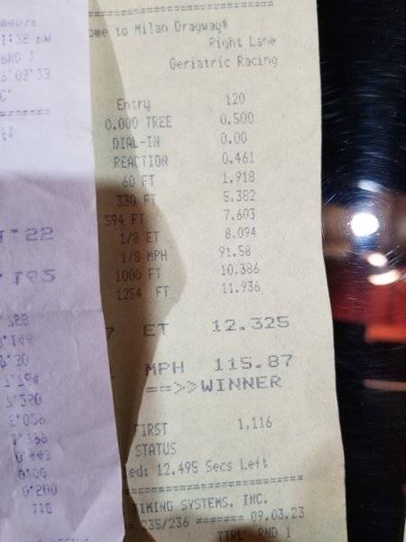

Yes thank you maybe next time went by myself. Drove the car from Lincon Park to Milan about 90 mile trip mainly a street car. Here was a better mph but was spinning.

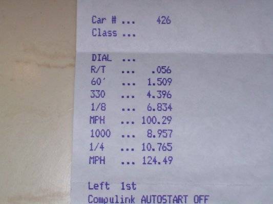

You will get there. This is my best so far and I run a 440/493 with EZ heads. Street car driven to the track and I never dyno'd my car but the charts say it should be around 600 flywheel hp. With your 615 hp you should be able to get in the 10's with hook once you get her tuned in real good. What does your car weigh ? I run 4.30's with a 30 x 9 tire. Good luck , Ron

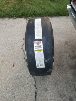

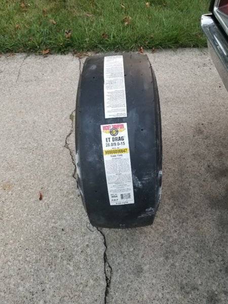

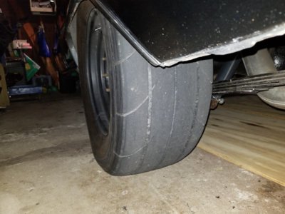

Not sure yet on weight. I was running a p255 60r 15. M/T SS Dag radial. Just bought 28x9 15 ET drag. Trying new shocks also. I have kyb now and hd springs stock interior and full 3 inch exhaust.

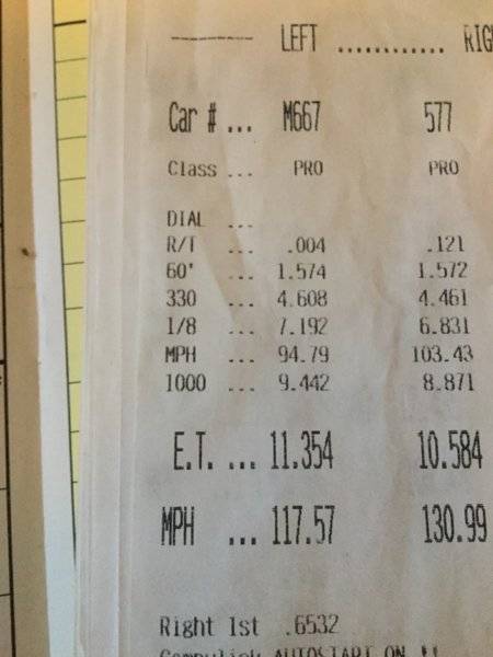

M/T ET Street SS 255’s should have no problem dead-hooking an 11-second B-Body. If they were spinning, track prep must have been really poor, or you had too much air in them. I’ve run 255 ET Street Radials on my car, they hooked great at 16 lbs. the ET Drags May hook better, but they generally will not be faster. If both hooked up, the Radials will be a little faster. I would have gone with ProBracket Radials; best of both worlds if you ask me. But I may be splitting hairs.
115+ mph suggests you have the beans to go 11.50’s, maybe even quicker. I’d still expect a little more out of an Indy headed 500” in a B-body with 4.10’s. I’ve attached one of my time slips for reference, your combo should be good for a little more than mine. Keep at it, it’ll take time and trial & error to get the most out of the combo.
