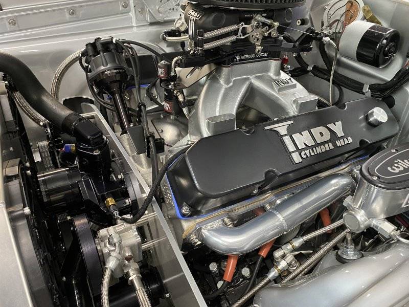

Torqe convertor,drive shaft,rear axle,bent wheel....probably not something in the engine unless its fuel or ign relatedHey Guys, I’m hoping someone can talk me off the ledge right now. Finally got the 572 INDy Max installed and running but I here is a really bad vibration that start around 2,000 and gets worse to 3,000 then starts to get better but never really goes away.
Short block was built by INDY the rest I assembled.
Callie’s Compstar Crank and Rods
Diamond Pistons
ATI balancer
Comp Solid Roller LowShock 285/[email protected] .711/.721 112 LSA installed at 109
440-1. 345cnc heads TD rockers
Not sure what to do at this point I’m supposed to be leaving for dragweek in 2 weeks but I can’t drive it like this for that long.
could also be harmonic balancer...does it vibrate in first and second?????Torqe convertor,drive shaft,rear axle,bent wheel....probably not something in the engine unless its fuel or ign related
Could someone explain how a cam could be at 109 at the lifter but 112 at the valve? I don't see how that's possible (i am not smart though)Got an update yesterday. Crank was out 34g on the light side. Rings were washed out and moly was worn off. Cam was degreed at 109 IC in the block (at the lifter) but at the valve was 112. Everything else was perfect, LOL
Plan is to balance the crank, Hone the block (Slightly ) for new rings, Reassemble everything and (While we didn't talk about yet) get it on the dyno before sending it back....
So far INDY's been pretty upfront and taking care of business, I commend them for that! They never denied reasonability and promised to make it right. Only thing is they are taking their time with it, probably wont see it till January. I have hope.
It was the rotating assembly, The motor is out and sent back to INDY a month ago. It was confirmed!
