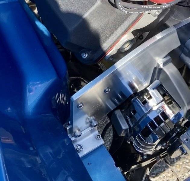

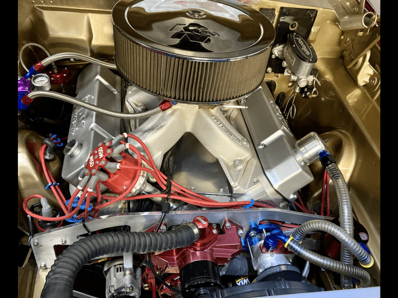

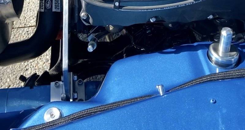

Spoke with Kenny from INDY today he’s going to Pull the record for the balancing of the rotating assembly and send it to me tomorrow . he said he very highly doubts it’s a balancing issue. According to Kenney, the crank is rough balance at Callie’s and is made specifically for this application, and then final balanced by Indy before assembly. But when he asked me how I had it mounted, and I told him I was on a motor plate with a polyurethane vibration pad between it and the frame. He said they tried it on tube chassis cars with a vibration isolator, and it made the whole car shake. He told me to pull the isolation pads and bolted directly to the frame and see if that helps. I need to make 3/8 thick aluminum spacers to keep the engine at the same height that I will install tomorrow going to start another thread about mounting the motor plate to the frame and how everybody does it.
I have the same bracket set up on both cars as you have.

-Replaced poly isolators from between the motor plate brackets and frame with aluminum shims of the same thickness. Helped some but not much.
-Made sure no part of motor or exhaust was rubbing frame.

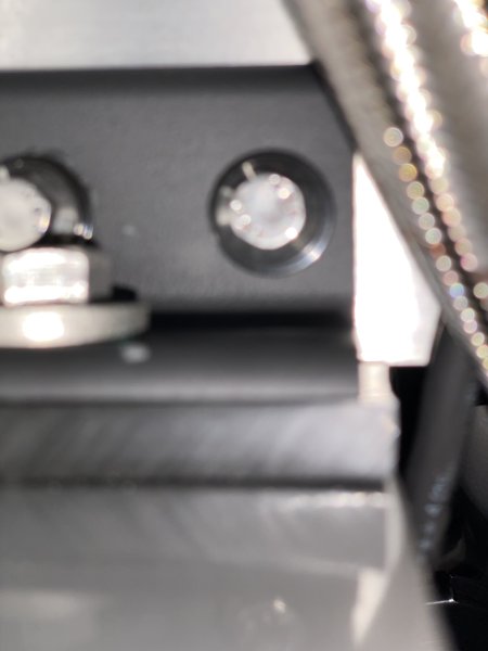

Maybe it’s in the converter? See the hop on the ring gear it’s not a lot but maybe!
MO Bingo! Hope it didn't bugger the pump bushing. That's not hard to replace, unless you forget to tighten the front band like I did.
