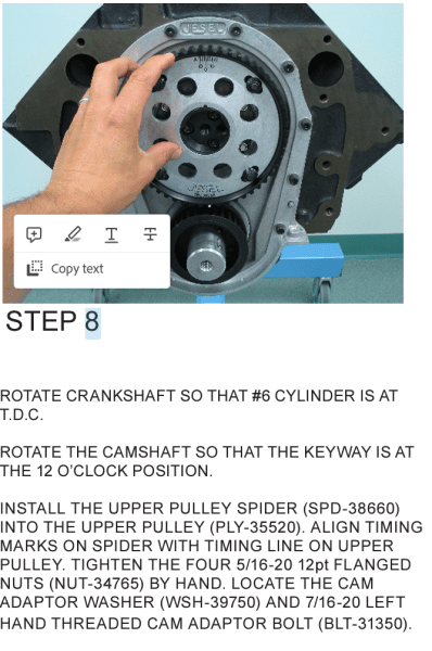

That's what I assumed but Why do the Jessel instructions say to line up Dot to Dot when #6 is at TDC which would be 180 on the balancer? I did not do this I aligned dots on #1 TDC.You cannot have the cam “180* out”.
Dot to dot on the timing set is number 6 firing, number 1 on overlap.
Rotate the crank one turn(Cam turns 180*, dots are now 12/12), thats number 1 firing, number 6 on overlap.
You can however have the distributor in 180* out, but the engine won’t run like that.
If you degreed the cam in properly, you’re good
As I said, there is no such thing as the cam being 180* out.That's what I assumed but Why do the Jessel instructions say to line up Dot to Dot when #6 is at TDC which would be 180 on the balancer? I did not do this I aligned dots on #1 TDC.
So the cam is not 180 out but the upper cam gear probably is, Which after it's degreed really doesn't matter. Correct?As I said, there is no such thing as the cam being 180* out.
If you properly degree the cam(degree wheel & pointer, cam follower, Finding true TDC, etc), you’ve eliminated all the variables associated with timing marks on the timing set.
Where Jesel is referring to the “key way” being straight up, that is referring to the key way between the sprocket and the hub. That is not the same as the “timing mark” on the sprocket.
In the pic you posted, the key way is at 12, but the cam timing mark is at 6.
Not trying to beat a dead horse but why make a reference to use #6 TDC instead of #1 for timing mark alignment? And If I didn't do that what are the consequences. Would it be that the upper cam gear is just upside down on #1 TDC cause that's what I got.As I said, there is no such thing as the cam being 180* out.
(If you didn’t do it that way, then you don’t really know where the cam is)
