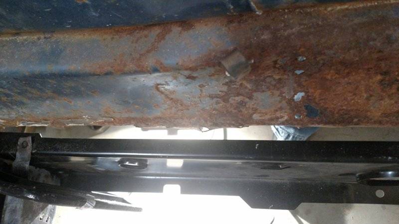

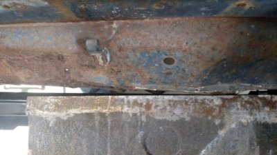

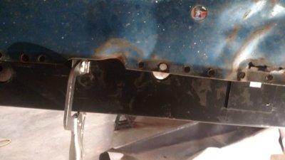

well, I'm at a stuck point. I'm jigging up the rear cross member and trunk pan trying to make sure It fits correctly when I realized the tail light panel doesn't look right. am I over thinking this or am I missing something. does the tail light panel attach to the cross member? if someone has pictures to help I would appreciate it.
IMG_20200219_175043673.jpg IMG_20200219_175018367.jpg IMG_20200219_175009692.jpg
The trunk floor goes over the rear frame cross member. The tail panel attaches to the trunk floor rear lip.

that makes sense to me. the problem I was having is the trunk floor pan I bought does not have a lip going down.

is that rear lip about 3/4 of an inch?
When I did a trunk floor in a 70 Charger before AMD sheet metal came out, I had a metal fab shop make me a 90 degree sheet metal lip to weld between floor and tail panel. The factory gobbed a lot of seam sealer there anyway, which covers up the extra weld area.

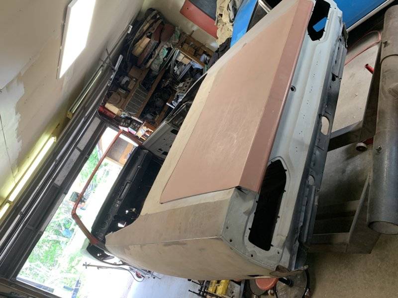

Get the service manual and download the 70-71 parts book. Here's what it looks like when finished :thumbsup:
