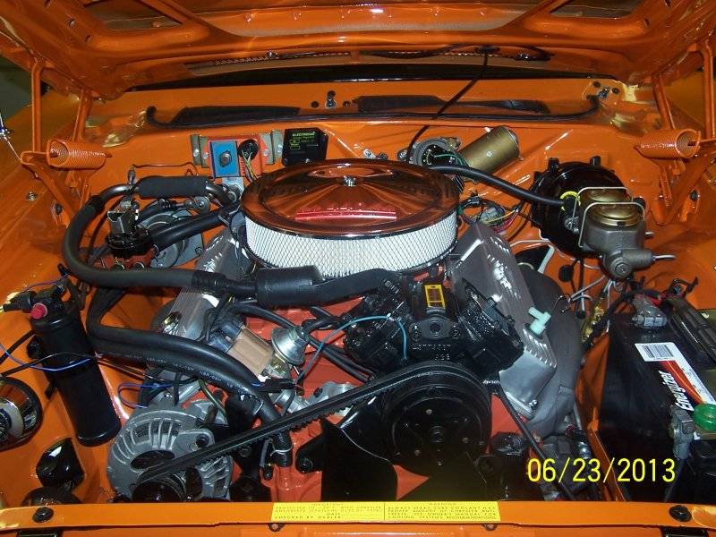

I'll have to look it up, I believe I used a CCP brake booster? I'm not shooting for Viper handling, that was just the advertising claim from Hotchkis.

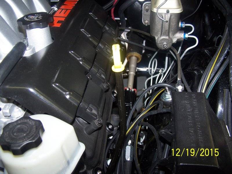

Yeah, I don't know much about the CCP unit other than I put one of them on my Niece's 70 Challenger when I built it for her. I didn't like the feel of it on her car so replaced it with a Bendix style dual 8" like I have on my Charger. Now that I think about it, I can't remember if it was 8" or 7" but it wasn't enough boost IMO. Here is a pic of the CCP that wasn't up to the task. I don't have a pic of the Bendix I replaced it with.

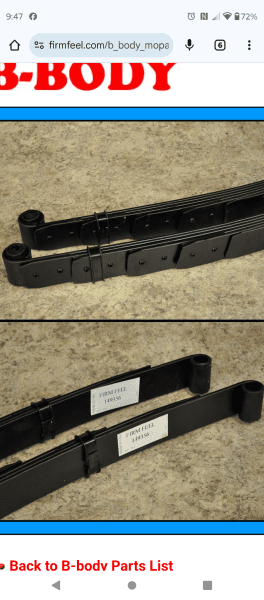

I thought I was going with Firm Feel, great guys but no, at least not the springs. I've had nothing but trouble with my current springs, one of the problems has been the "banding straps" like pictured on Firm Feels set walking off of the stack. Hotchkis appears to use the heavy duty straps that are pinned to the stack. Surprisingly Hotchkis is cheaper and come with hangers and hardware.

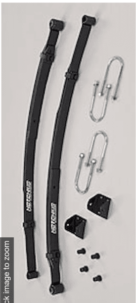

Hotchkis are lowering springs, make sure that is what you want. The best springs I have found are from Springs n Things - https://www.springsnthings.com/ The build them exactly how you want and have high quality parts.

Not sure what is going on with your brakes. Do you have the dual diaphragm 8" booster?

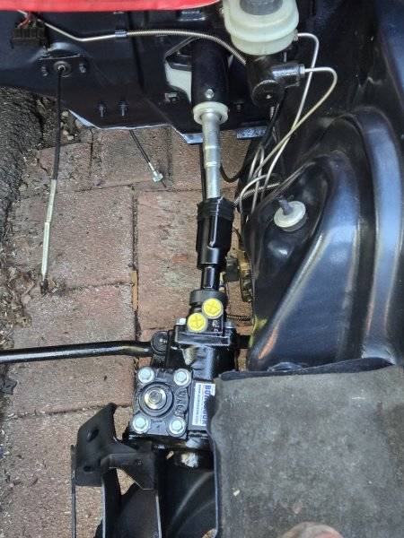

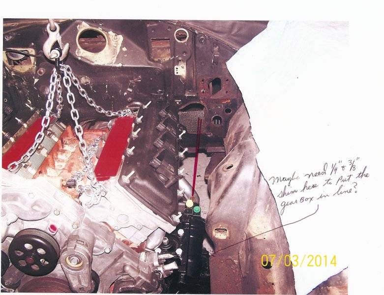

Hi do you have a pictures of your borgeson box. Mine has very off center. Didn't shim it yet.
I doubt they'll be low enough, they're only 1" drop, I'm closer to 2".
The Hotchkis ones are an easy 2” lower than stock. The drop from the front hanger is an 1” alone … then the springs are nearly flat.

The Hotchkis ones are an easy 2” lower than stock. The drop from the front hanger is an 1” … then the springs are nearly flat.

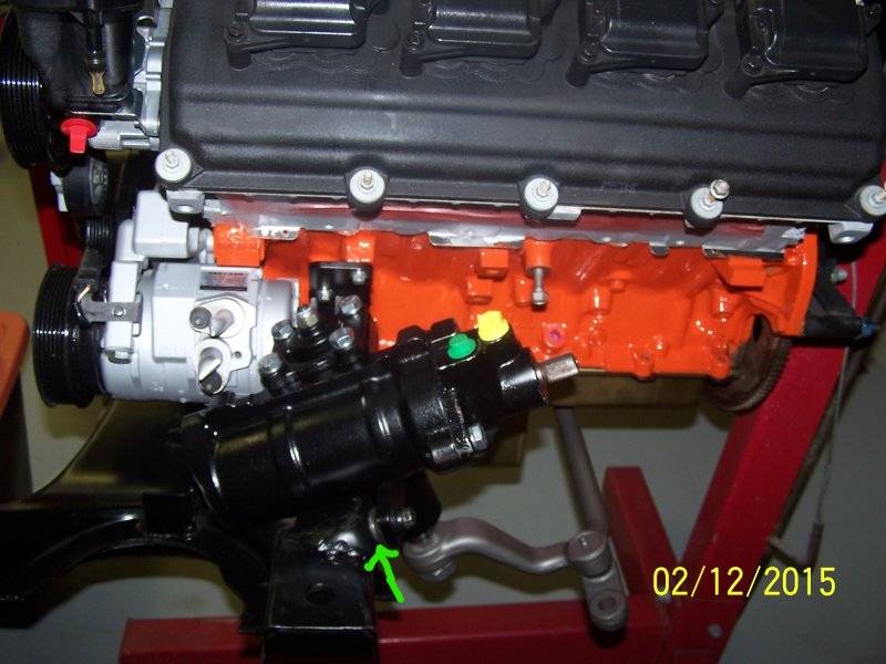

Mine was not centered properly either. (at least to my thinking) I ended up adding a 1/4" thick washer to put it in alignment. I thought they may have fixed that issue since mine was one of the early ones. I didn't like how it was tilted out and contacted Peter about it. He thought the angle was fine but said the shim would be Okay. He said he was going to look into the issue. I never followed up on it so just thought it got fixed. Maybe not huh? Anyway, here are some pics of mine and how I fixed it. Pic #2 shows the spacer. I have checked the bolts a few times over the years and it has never been loose

The hotchkis springs don't have much arch when installed. Sorta maxed out.

What does the mounting flange of the Borgensen box look like compared to a stock box? It must have different mounting pad heights.
