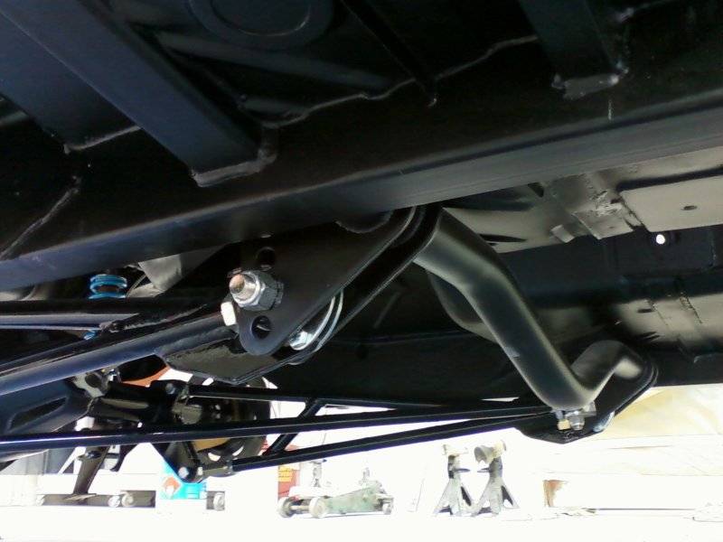

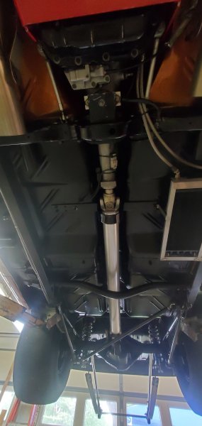

That is exactly how mine looked before adding the 1/4" spacer. I thought it would have been an easy fix for Peter. They could have just made that ear 1/4" thicker before welding it on. Guess they were more worried about the box hitting the headers than shaft alignment. Peter did tell me that the coupler could handle the angle but I felt the shim was the best choice.Hi sorry thanks again. When springs hits here in Ma. I will give it a try.. thanks again.
