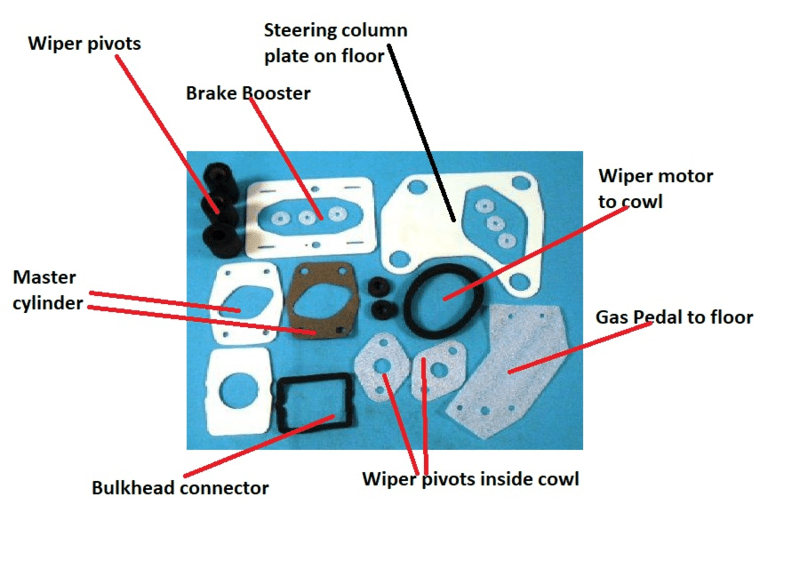

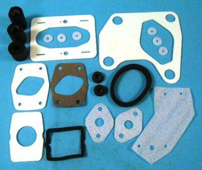

I can't figure out where all of these gaskets go on my 1967 Charger. Also, the round/oblong gasket, is that supposed to go around the base of my 3 speed wiper motor? I just went to Laysons website and they show a separate flat gasket for $39.95 for the 3 speed wiper motor.
Any help is appreciated.

Hopefully I got this right. Maybe the longer black tubes are for the heater pipes through the firewall, and the shorter two are for the wiper pivots.?
:welcome:
I am happy to be corrected above if I have any wrong - this may help others in the future. :thumbsup:
