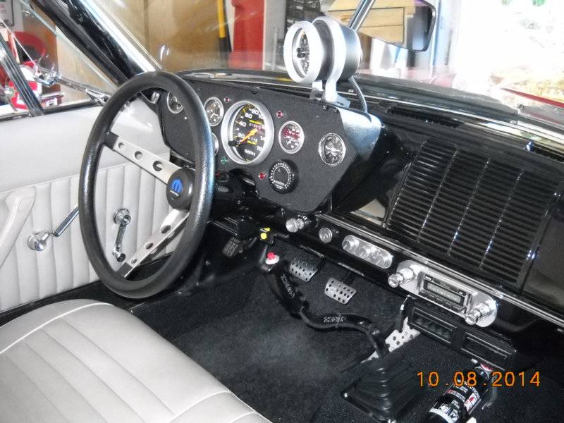

Classic mount is either on the tunnel, or under dash passenger side. Don't leave home without it. You'd be surprised what a disaster is avoided using it. I know.

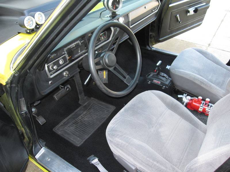

Keep one on the floor or seat on passenger side, some day I will mount it somewhere within reach.

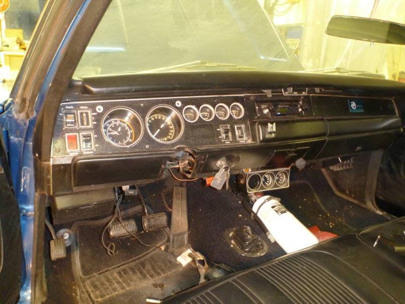

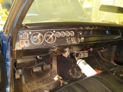

I have a 4 speed 70 Road Runner with a bench seat. I mounted a good sized fire extinguisher on the opposite side of the shifter on the transmission tunnel. I spent WAY too much time and effort restoring my car to have it burn in a fire...
Have one on the passenger side of the transmission tunnel in my car, too. Little quick release clasp, quick and easy to get to. ...And as others have said, get Halon or some available derivative if you can help it!
