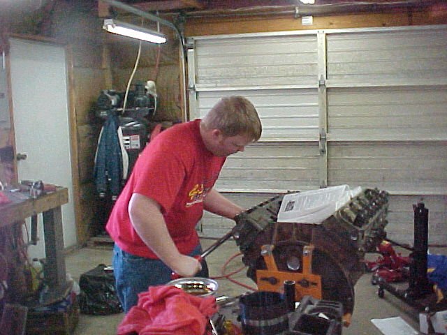

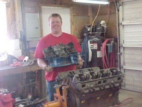

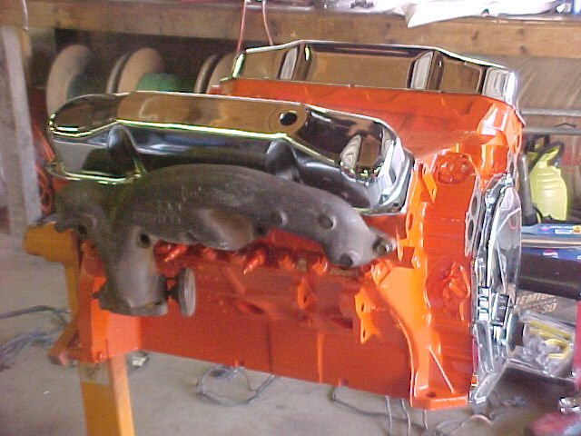

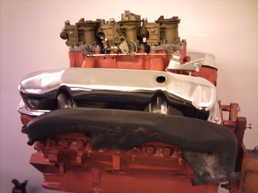

My buddys first engine.

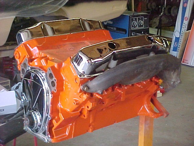

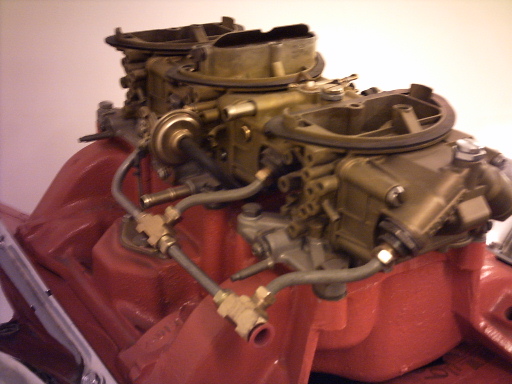

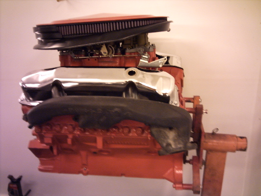

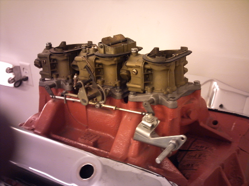

Where are the vacuum pods for the outboards? Any idea what cam he is running in that?
484 cam, not to big but agressive enough. have vacuum pods just have'nt got them restored know where i can find some trim
That cam is big enough you will have to spend some time with your carbs. It won't pull the same amount of vacuum at idle as a stock cam, so you will have some issues.
You also may not like the way it runs with the stock manifolds. They really only work with a split profile cam. NOT what you're running
