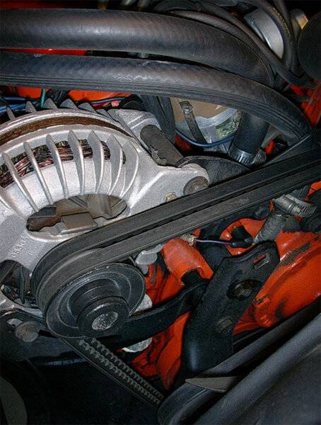

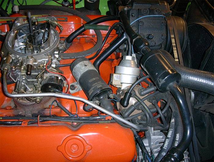

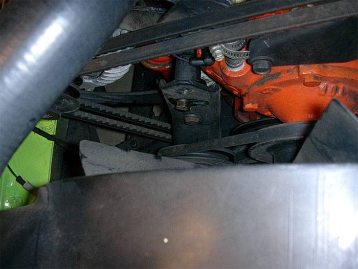

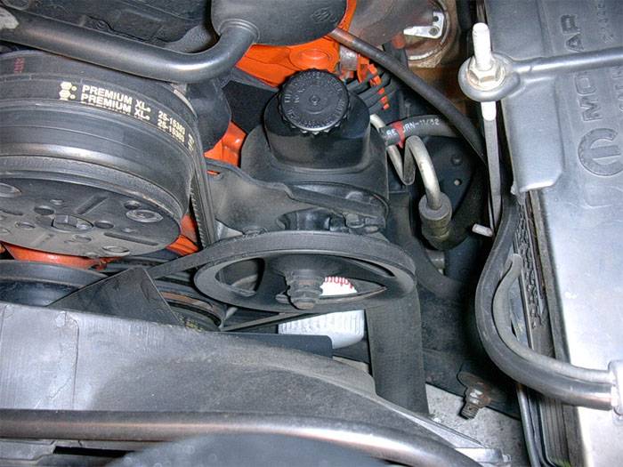

The way the belts are on an A/C big block in 69-71 the water pump is driven by a short belt that turns the water pump & an idler, it's driven by the crank... A pair of belts run the A/C & alternator & a separate belt runs the PS... Likely the noise was an alternator bearing & it locked kicking the two belts which got into the P/S belt taking it out.... The W/P belt is so short it rarely gets taken out...
These photos are my Challenger but the brackets & pulleys should be the same....

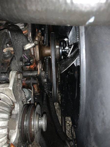

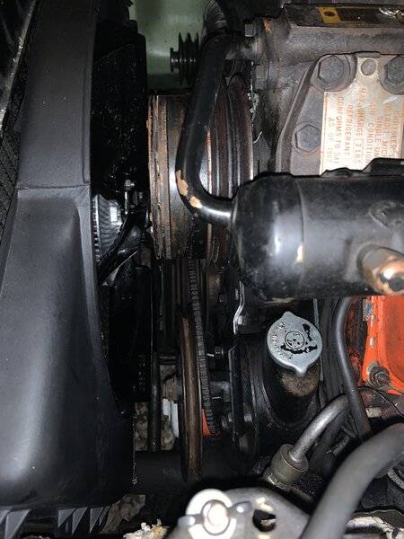

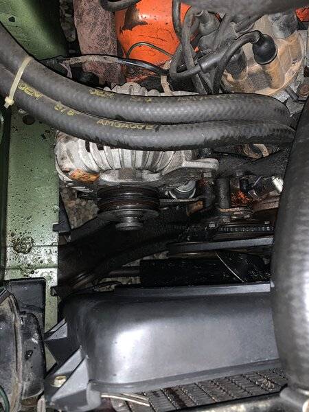

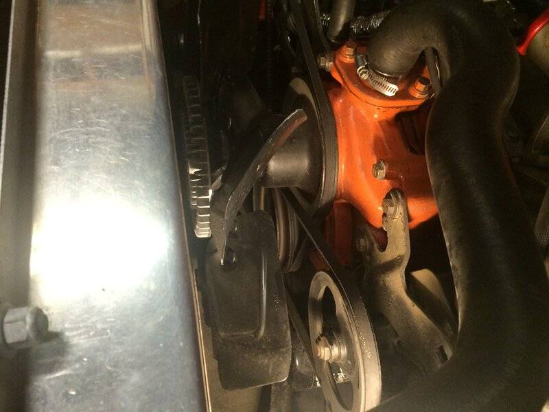

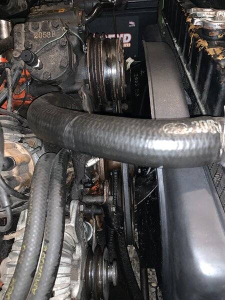

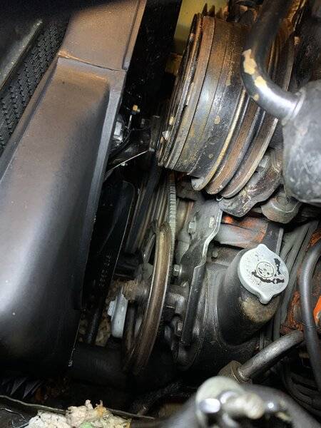

So today i did some further inspection and yes it threw multiple belts, not just one.
Basically the only belt still on is the water pump belt!
I think it is the factory setup, i attached some pictures.
I turned the alternator and power steering pulley by hand and it spins very easy. No noises, no nothing...
I really expected one of them to be locked but it seems like that is not the case.
Maybe it was a real bad chain reaction when one belt snaped off due to age?
Maybe the whining comes from the transmission? I mean why not a transmission rebuild. :D
