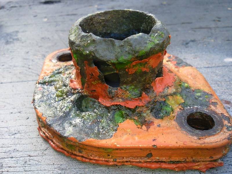

Check your water neck and water pump housing. Those should be cast iron but might have been replaced by aluminum versions. Had a small water neck leak once that eventually resulted in a large coolant loss. Problem was that it was an aluminum piece that was eaten away by electrolysis under the paint. It looked almost normal from the outside but after scraping the paint of it looked like swiss cheese on the inside... go figure
This is backwards. 1969 had aluminum water necks. The last year of the cast iron water neck was 1966 and it was angled forward at the top outlet. Then sometime in the mid to late 70’s they started with the cast iron again.

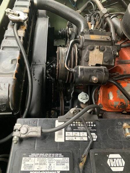

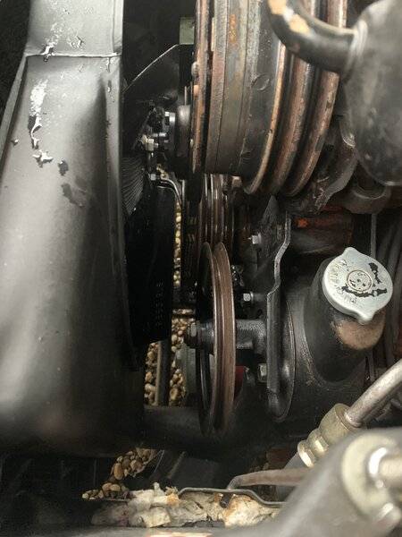

While i can easily spin the alternator, ac compressor and power steering pump pulleys by hand, i noticed that
the power steering pulley appears to be somewhat bent. (See picture, but looks worse in person).
Its also misaligned with the crank pulley at the bottom of the engine.
So i suspect there are two possibilities that could explain what happened:
1.Water Pump leaked down to the crank pulley, belts slipped out of the pulley due to being wet and finally snaped off.
2.Power steering belt slipped out of the pulley due to pulley being bent causing all the belts to snap off as a chain reaction
2.1.But maybe the pulley bent when the belts snaped off?

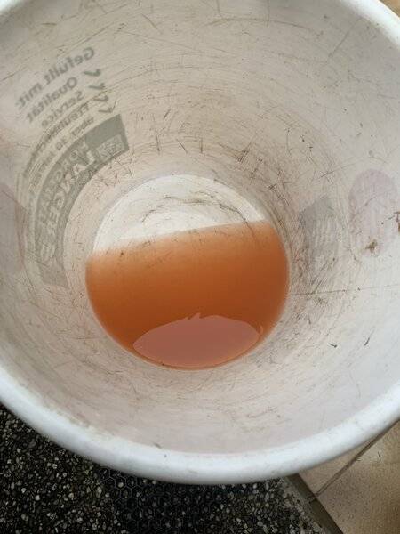

Also this is some of the coolant that came out of the overflow hose:
I think it looks pretty good?
Trying to figure out if i should flush the cooling system with some chemical cleaner before installing my new radiator or not.

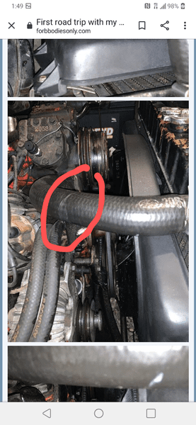

Could one of your belts have damaged your upper radiator hose?
Doesn't really look like it cut through but i got a new upper and lower radiator hose, anyway.
That power steering pulley can be removed n straightened,n that coolant colour looks rusty to me,clean n replace
I would take that PS pump out and check the pulley and shaft. It looks like a Saginaw with the nut that holds the pulley on, so very easy to remove/replace. But it could also be the shaft on the pump, in which case you can just replace the whole pump which you can get from various vendors like classic industries.
