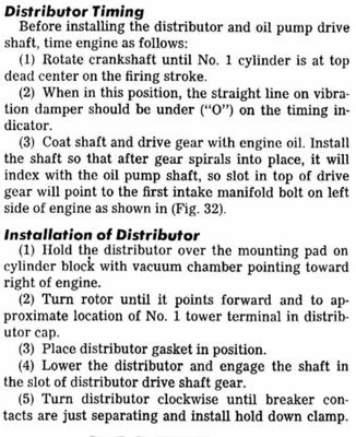

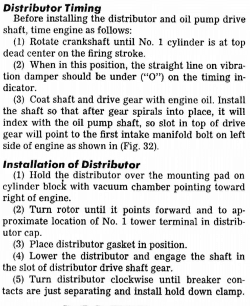

I will post the proper clocking for both types of distributors, straight for the Service Manual.
  • 31-340-DISTRIBUTOR-DRIVE-GEAR-ALIGNMENT (2) (1).pdf
  • 383-440 DISTRIBUTOR OIL PUMP DRIVE INSTALL (1).pdf

Installing intermediate shaft as mentioned, at cylinder #1 TDC the slot should be pointing towards the #1 cylinder (if you want the factory spark plug locations in the cap.) Use a large screwdriver to position the intermediate shaft (oil pump drive).
Now you need #1 cylinder near TDC of the Compression stroke (Both valves closed). usually rotating the engine with a finger on the #1 spark plug hole will indicat compression stroke when the pressure pushed your finger away from the spark plug hole.
Install the distributor with the rotor pointing forward. It should be pointing towards the #1 cylinder if the intermediate shaft was positioned as above (if the dist rotor and oil pump gear tang are in-line?) Have had a distributor where they were not in line, and that would require either moving the pump gear position, or moving the plug wires (as long as #1 plug wire is in the cap terminal above the rotor.)
