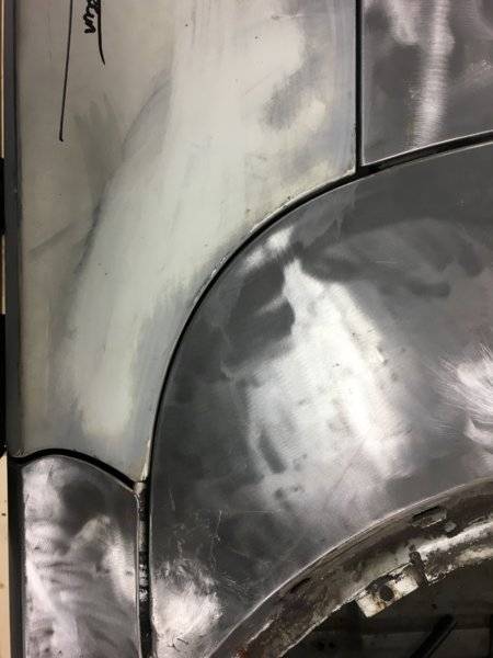

Hello,
I’m currently doing test fitting of the doors, fenders and hood on my Coronet -66. It seems like the hood is almost 1/2 inch “too short” in the front. Are the fenders supposed to be installed against the cowl panel without gap? If so, I will get a little better alignment of the hood and fenders in the front, but not enough though...How big should the gap be between hood and cowl panel?

Your picture looks pretty close. Move the fenders back till they touch with a thin card stock between them and the cowl. Then pull the card out. Don’t alight the hood and fenders at the cowl, there needs to be a wider gap for the hood. Move the hood forward until you are happy at the front. Nobody looks at th hood to,cowl gap, your eye is not drawn to it.

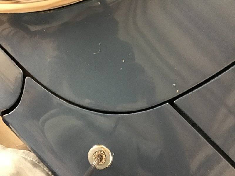

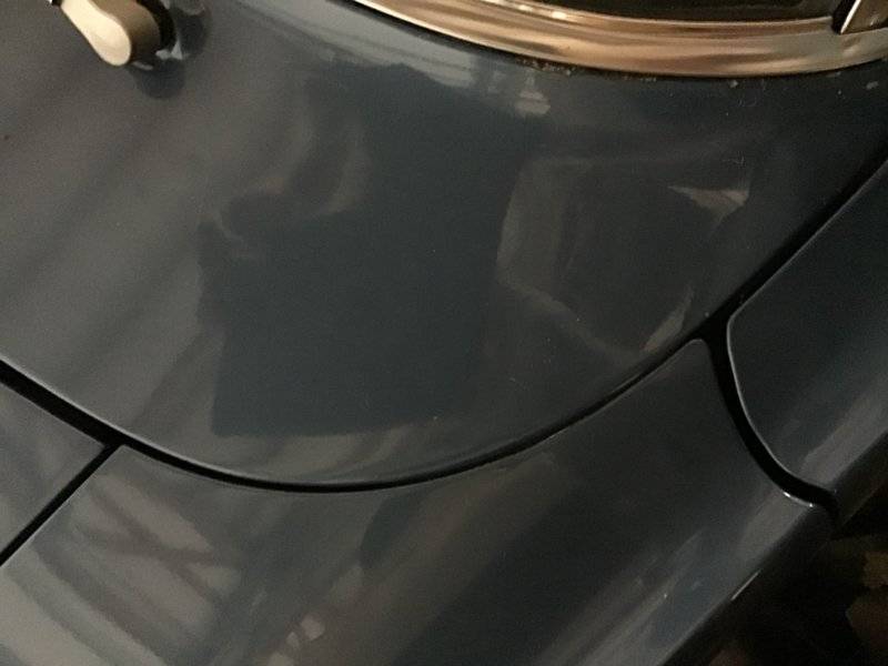

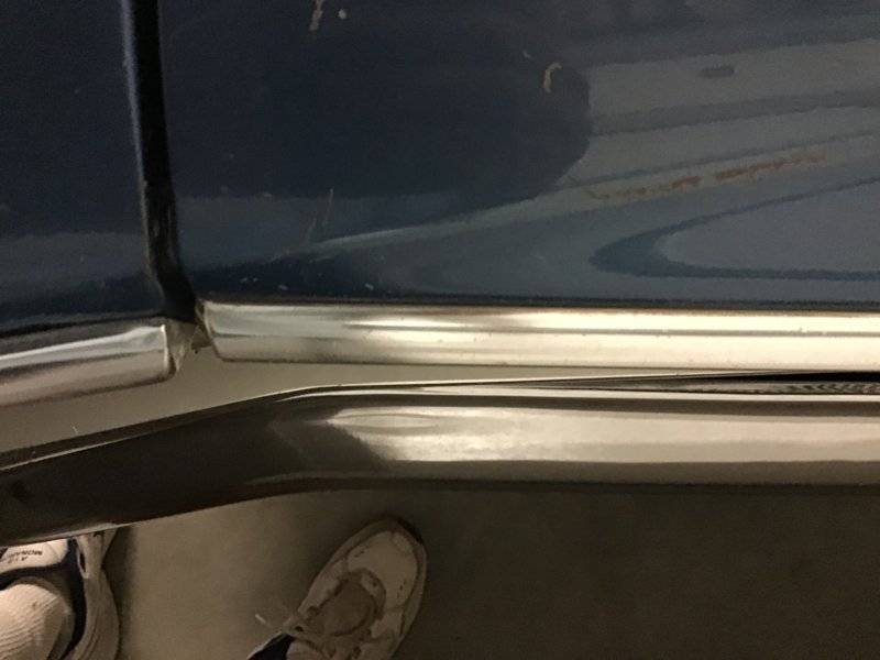

Here is a blue 67 Coronet, it’s original paint, never had any panels off. The hood is a bit short on one side at front. These cars were mass produced in a hurry so they are not all the same, the tolerences were wide.

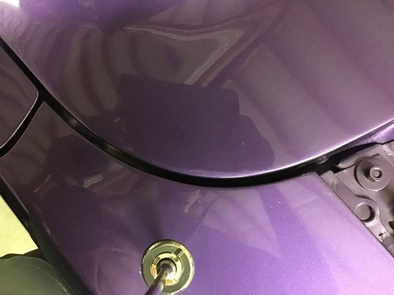

Here is a 1970 see the much bigger gaps fender to cowl. F7358198-2048-4035-9177-3BBA8E59EDC9.jpeg
