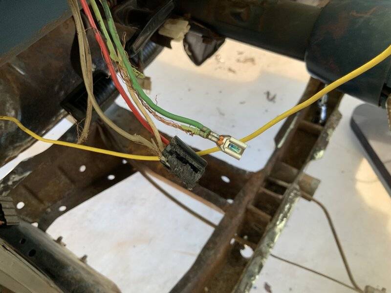

Where can i purchase the correct flasher connectors something was eating my wire.
Looks like it ate your floor pan too! Tin worms!
Try Rock Auto, NAPA, O'reilley's. They carry pigtails & connectors.
Where can i purchase the correct flasher connectors something was eating my wire.View attachment 1146898
Try NAPA or OREILLYS or similar.

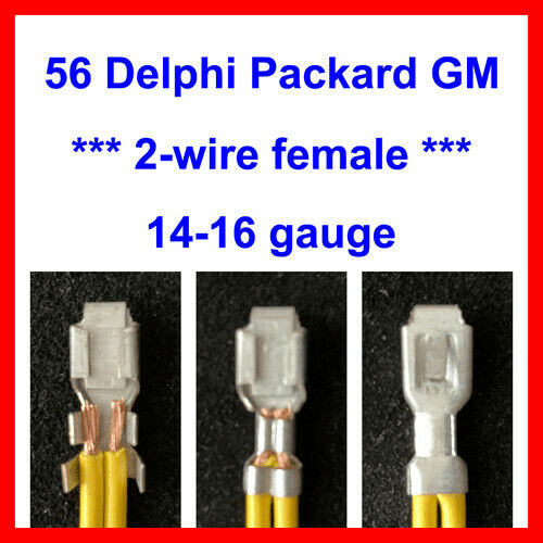

They should or can get the crimp tool as well. Google Packard 56 connectors...they come in various sizes to accomodate different wire gauge sizes....

Someone needs to put a link on here for the parts needed. NAPA doesn’t have a clue what a Packard 56 connector is and I have yet to find anyone who carries a double female connector.
But hey! Looking closely that's not the flasher conector but the hazzard SWITCH conector used on 68/69! A 4 ways one. Flasher is a diff thing.
This is the one for the SWITCH.
https://theelectricaldepot.com/weat...48-56-series-4-way-female-connector-br-5-pack
Here is another supplier
https://www.delcity.net/store/Female-Packard-Connectors/p_9287.h_810140
About terminals, the more correct ones would be packard 58, but 56s will work too. Packard 58 are made of unobtainable.
Same conector suppliers got the terminals available.

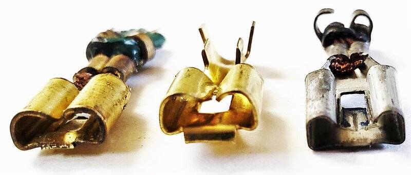

Napa pieces are in the middle of each picture. Brass original on the left, steel original on the right!
