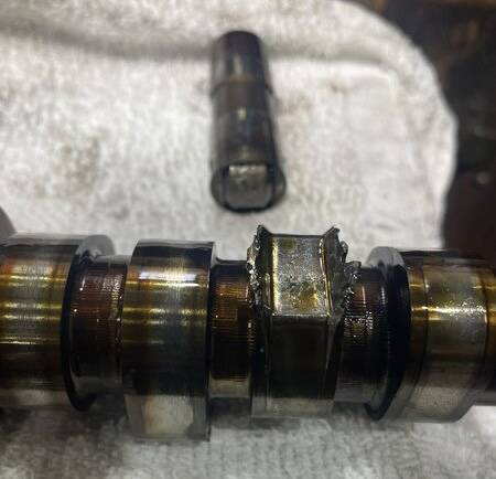

IF there is a mechanical failure it could be the lifters are at fault due to incorrect machining tolerances or surface finish.
But it could be the cam at fault as well if it is not in specification.
If you find lifters which are stuck and cannot rotate it is easy, then again.... they could have spun freely in the bore but due to poor machining the force provided to rotate was not sufficient while running.
Many options of failure, but only for those that fail due to a mechanical issue.

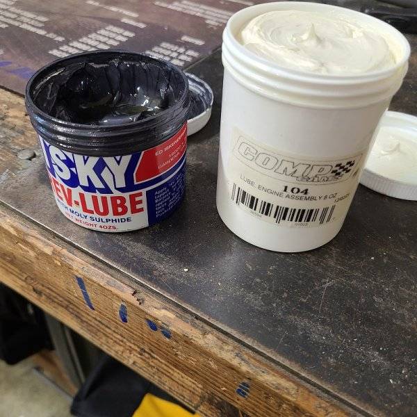

That's where the moly paste comes into play, this is there only for the time the engine cranks and fires up and no oil flow is present yet but will follow soon after (therefore priming is a must to shorten this time)
