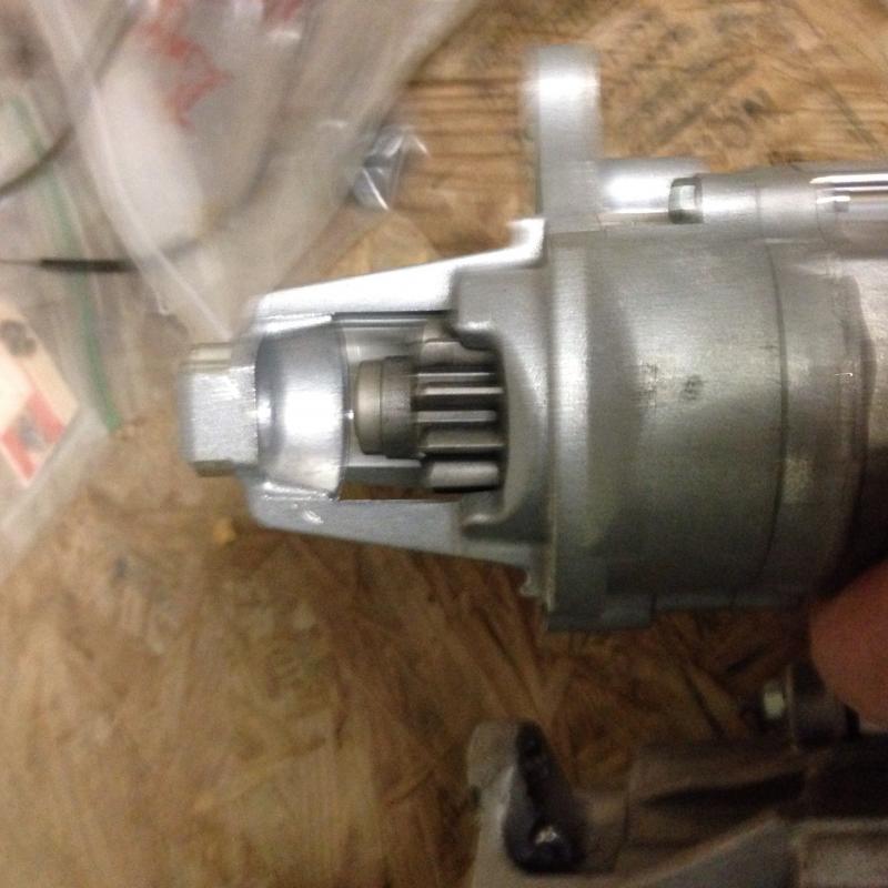

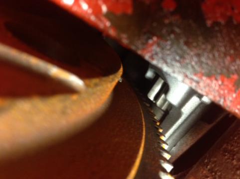

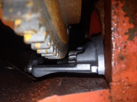

looking at the starter in the picture vs the mini starter i have laying around and the bendix's look different,....? pull that starter out and take a pic.
Then I don't understand why. They are both 11". I guess I wait for Brewers to look at it on Monday.

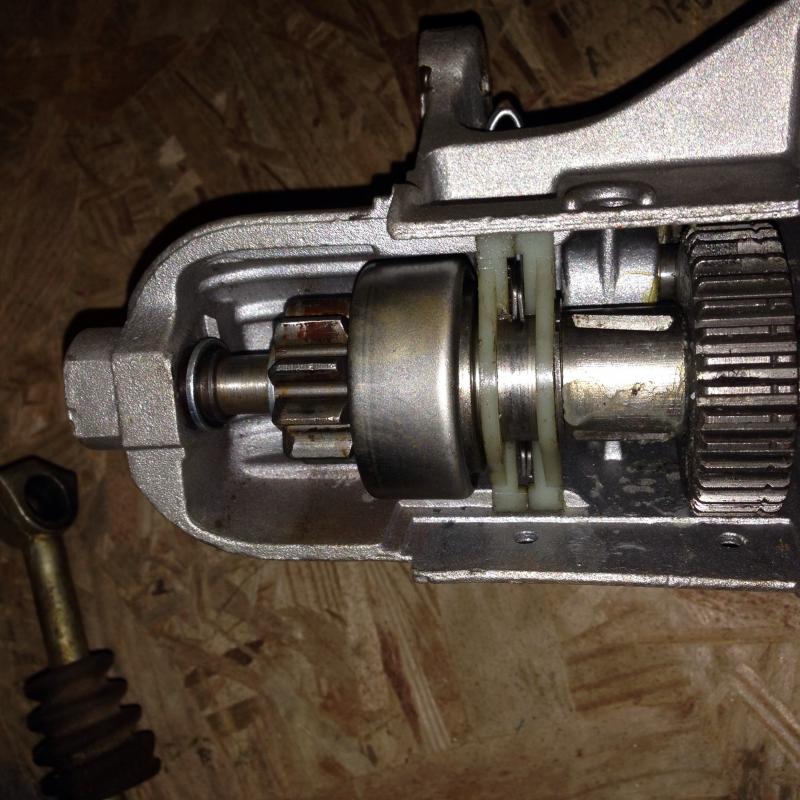

Here is the mini starter and a full size.

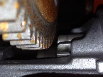

The factory starter fits correct? The teeth on the flywheel clear the shaft that the starter gear slides yes?
If they dont mesh, the only other solution i can think of would be to use offset dowels to mount the bellhousing to the block. Probably wouldnt hurt to measure crank flange to bellhousing runout. If the bellhousing is off center to the right slightly it would push the starter too close to the flywheel
either you do not have the right starter or your bellhouse is wrong for the flywheel or visa-versa...................................MO

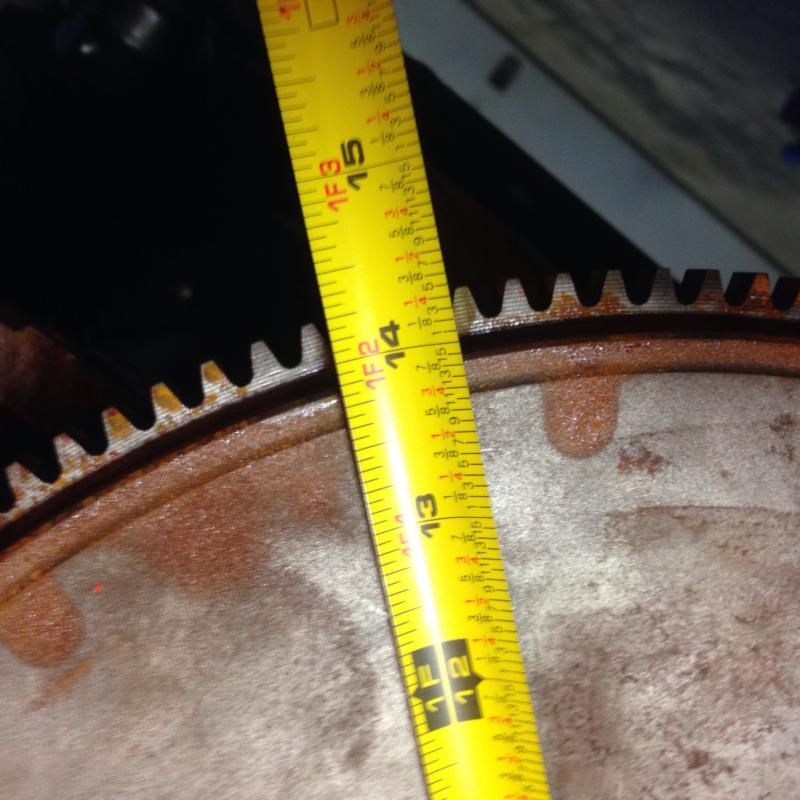

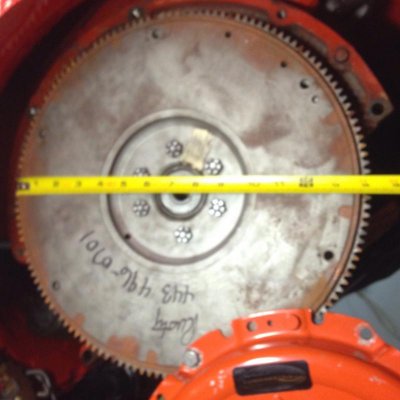

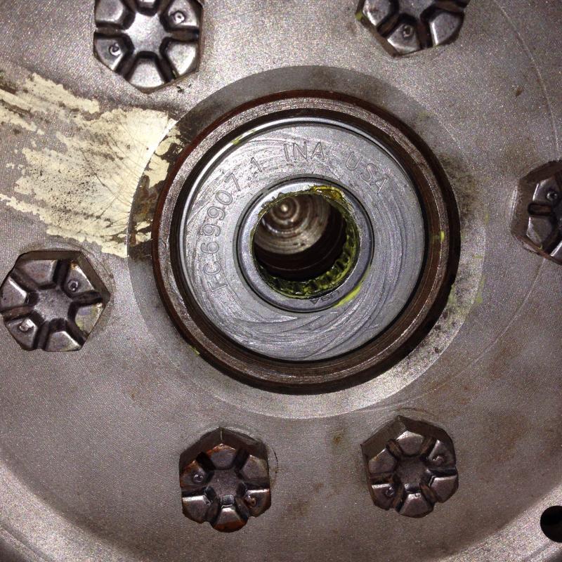

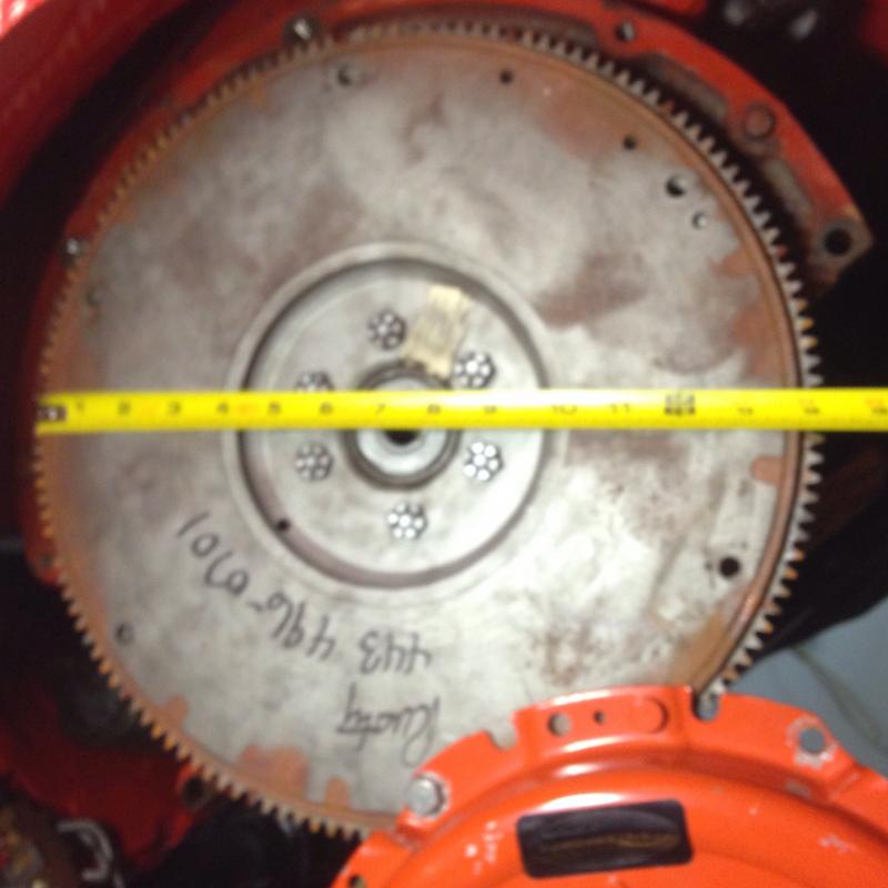

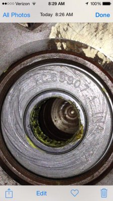

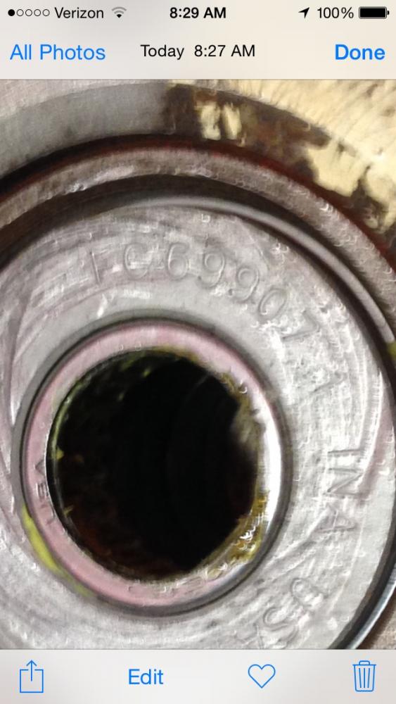

Starting to think its truck flywheel. It measures 14.25" OD.

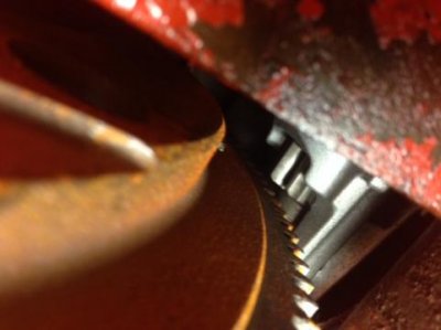

I think I resolved the issue. Took it all apart, reinstalled it all. Snugged it up and it appears to line up now. Tight tolerances, but it will work.
