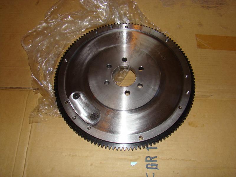

So, I have heard that some flywheels have bolt on weights for cast crank engines. (440 Source, Hays?) Anybody seen this? Even better, anybody got a picture? (I'm solving some vibration issues on my 440/4spd conversion).

SOOOOOO, back to point. I have read that some hi-po flywheels have come with bolt on weights. I would reference a thread on the A body site about 440 Source neutral flywheels coming with bolt on weights. I simply am asking for a pic of said weight for reference so I know what to look for when I crawl under my beast at start poking around.

OK, so what I mean is something like this....
Interesting. Never heard of such a thing till you axed da question
If you take the "externally balanced" weight off the flywheel wouldn't the flywheel still be out of balance for an internally balanced engine, just because of the two weight mounting holes?
I just bought the identical flywheel from The Driven Man in Tennessee. Believing that it was domestically produced, I paid appreciably more than the 440 source price and it turned out to have the same part numbers. Anyway, after removing the bolt on weight as I have an internally balanced engine, it appears that the flywheel is going to be out of balance because it has four (not just two) holes drilled and tapped for the weight. No other holes other than for the clutch. I am going to have it checked just to be sure before installing it.
Yeah, there are going to be a couple of different positions for the weights. There are actually a couple of different weights, also. From what I have been able to learn the reason would be the flywheel will fit small and big block Mopars and there are different configurations for external balanced SBs, external balance BBs and sixpack motors.
