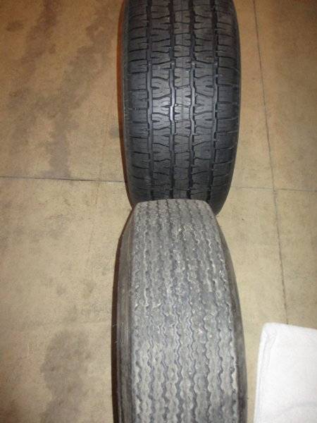

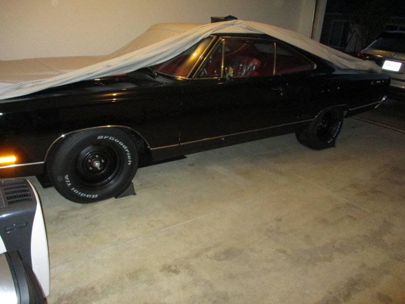

The X got some new tread today! The bias ply's look dinky in comparison, lol........I love the A12 look......
Thanks to Mark for the advice on the tire choices(size/back spacing)!

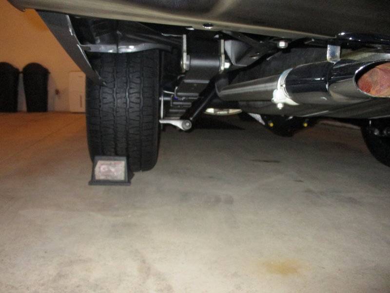

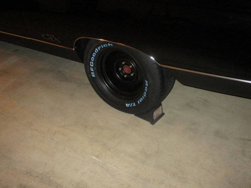

Oh wow! So many questions...
Did you put the bigger wheels/tires on for fun while the 14s are off getting repainted?
Please tell, what wheel size and back spacing? What is the tire size(s)?
Are you going to use the new tires as "drivers".
Sizes as follows
Fronts.....235 70....rim 15x7 4.25bs
Rear......275 60.....rim 15x8 4.5bs
Usage.....hmmmm....right now for rolling purposes, lol......other than that just a spare set....maybe for a look change in the future.....
