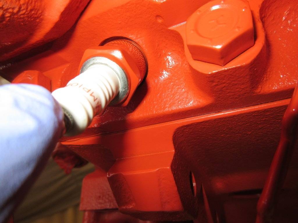

Ground straps originally were masked off on the firewall side. During assembly sometimes not all the tape was removed. Sparks plugs were assembled during engine painting and they got covered in this manner.

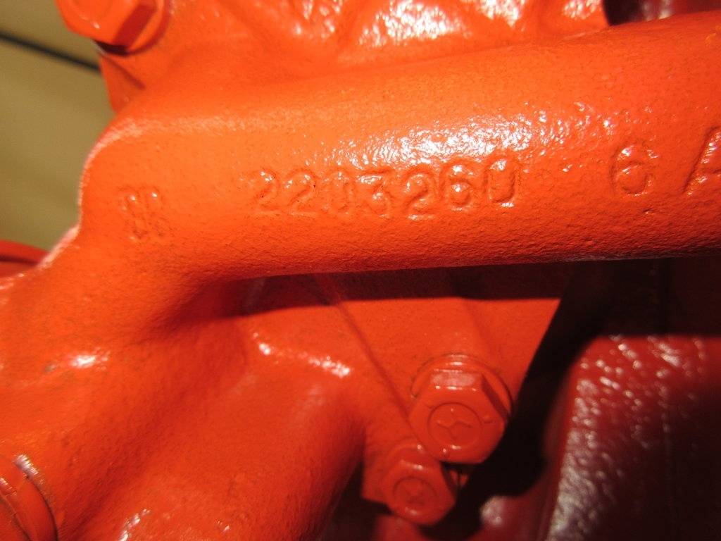

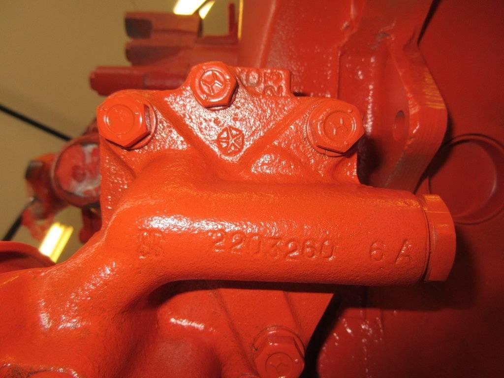

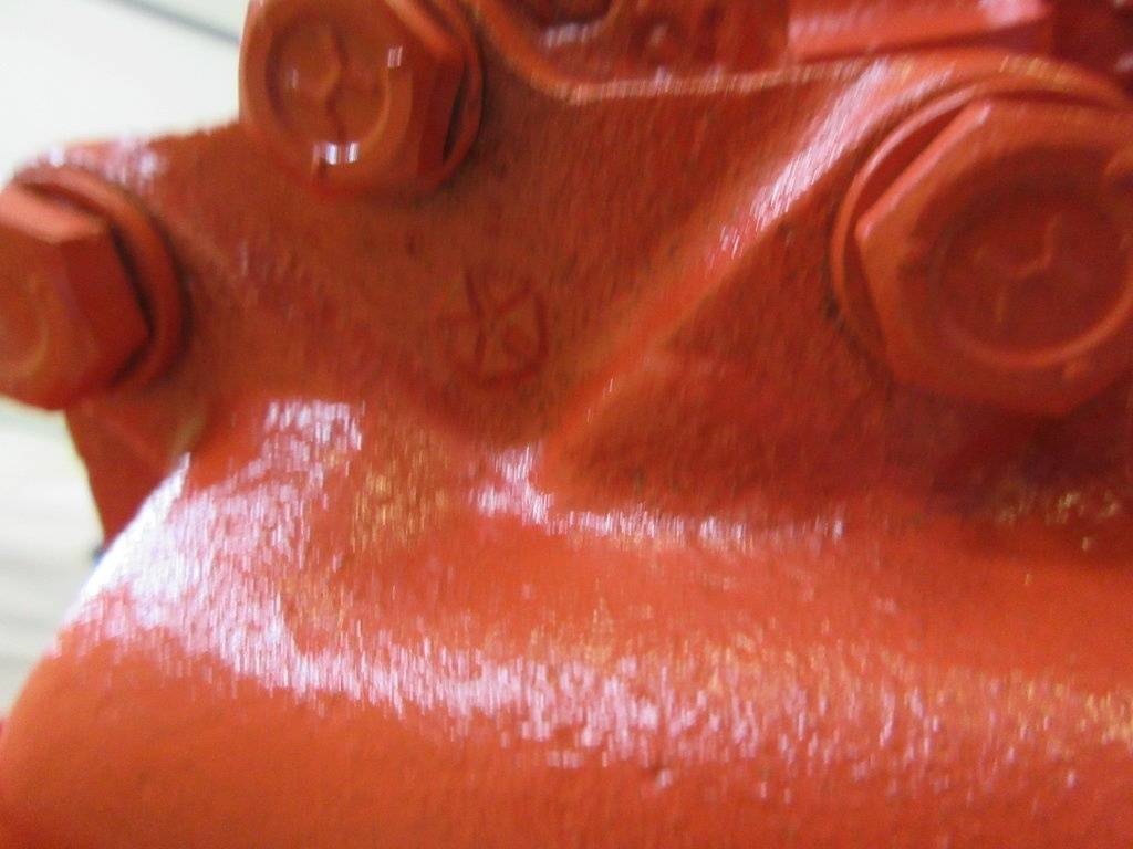

Original 440 oil filter cover with relief valve..

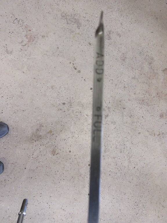

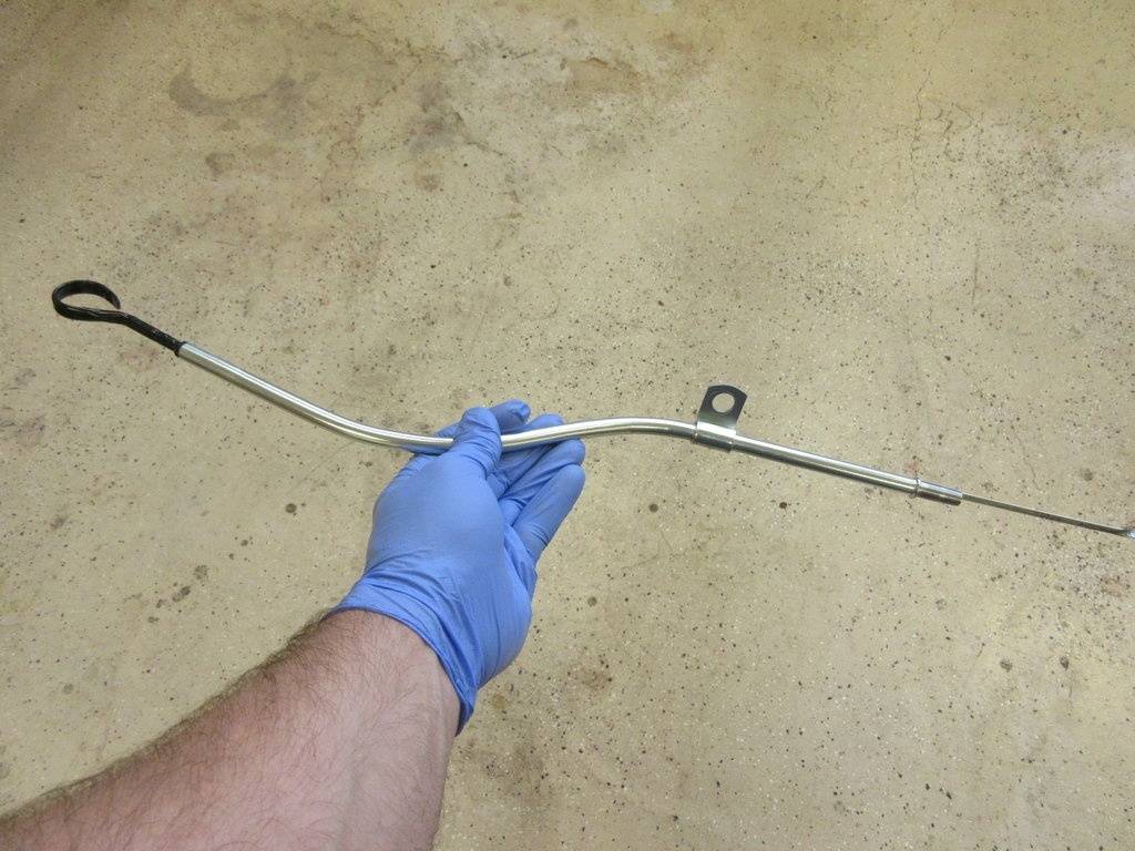

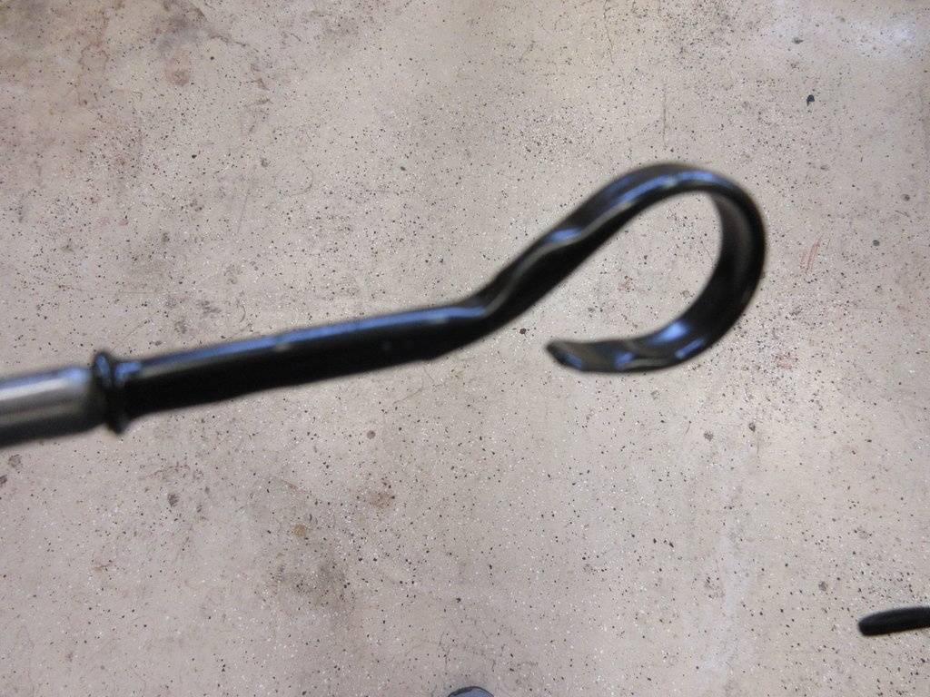

Orignal Dipstick and new tube from Frank Badalson. The end of the dipsticks were dipped in semi gloss black paint as I did the same with this one. The original dipstick has a specific length and font and repro's are not correct...

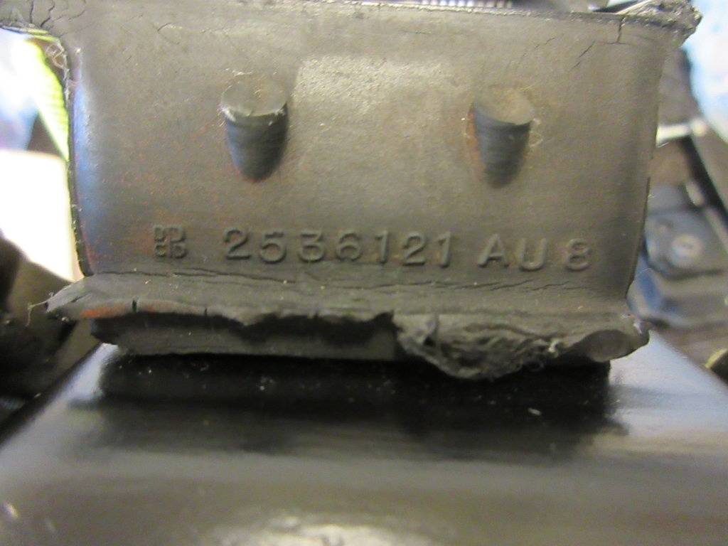

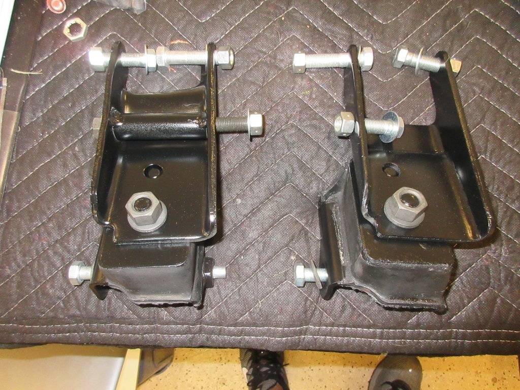

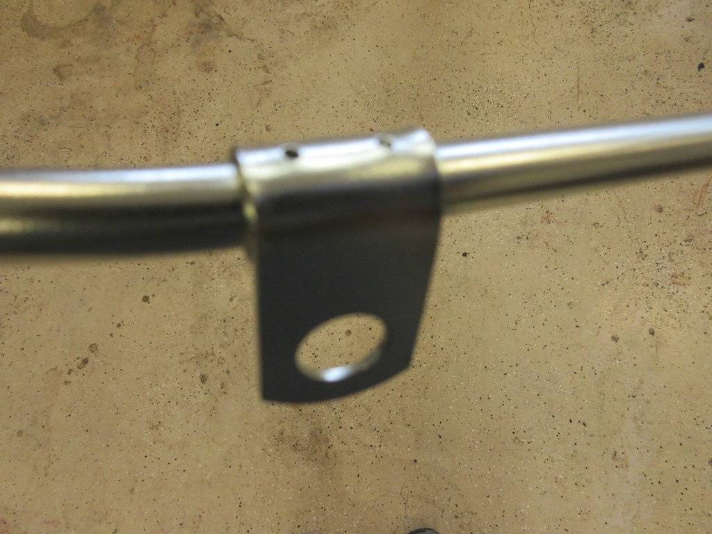

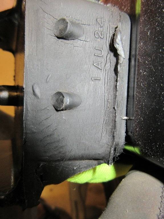

The motor mount brackets to the block were cleaned up and sprayed with semi gloss black. The mounts themselves are an NOS set. Original hardware mount to bracket was zinc phosphate. The hardware kit for the bracket to block is from Frank Badalson...
